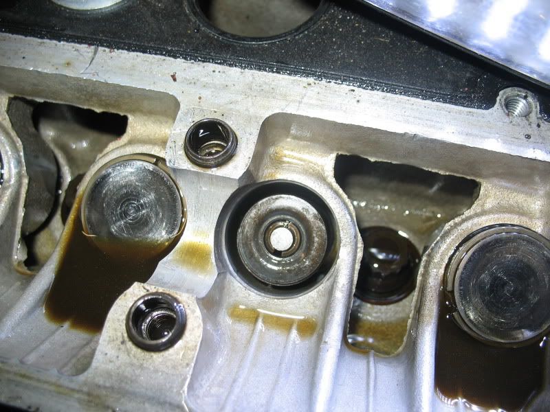

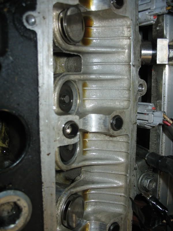

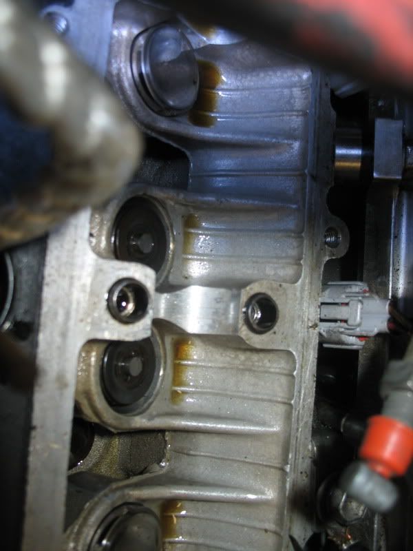

So here are some pictures and a video of my problem. I still dont get it. It moved so freely, then got stuck again. WHY?!
The only thing I can think of is that the valve gets hung up below where I was pushing it. But I was moving it down pretty damn far. And was only stopping for fear of dropping the valve into the cylinder. :( I DONT GET IT!!!!

The bucket itself might be causing the lockup- have you tried checking the freeplay with the shim bucket on??
Oops- i take it back- looks like one pic shows how the valve is depressed without the bucket.
Yup, bucket came out just like it should. My magnet sucked it out, just like normal.
This is so bizarre and so frustrating... UGH!

Andy.
The valve is bent or scored. It works when you press on it because you are over coming the burr on the valve stem, or rotating the valve where the bend sits in the worn out valve guide just right.
There are 103440294372857209587250892742048207 x 99 things that could have caused that valve to bend.
Id say it was either:
-A deposit on the valve stem itself, and when the cam came around it bent the stem
-A weak or broken valve spring
-A broken or worn out valve guide
-Debris inside the cylinder making contact with the valve head
From here, Id say suck it up and get a Uhaul trailer or have the car towed to where ever you are going.
