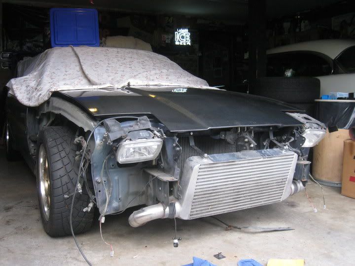

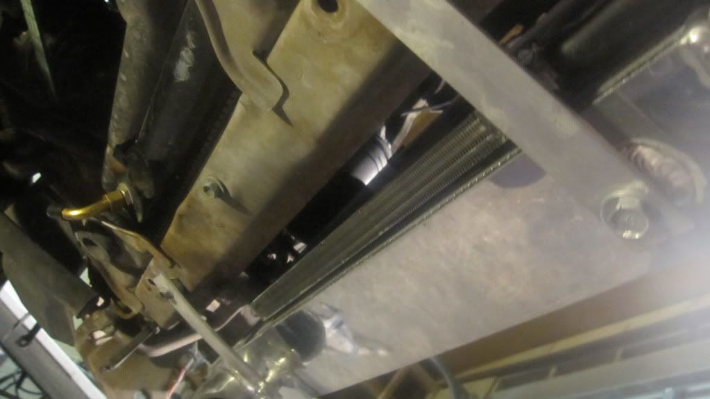

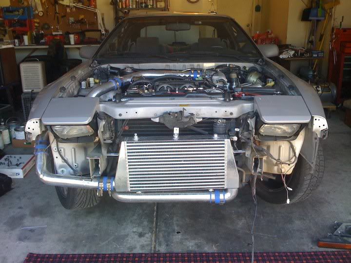

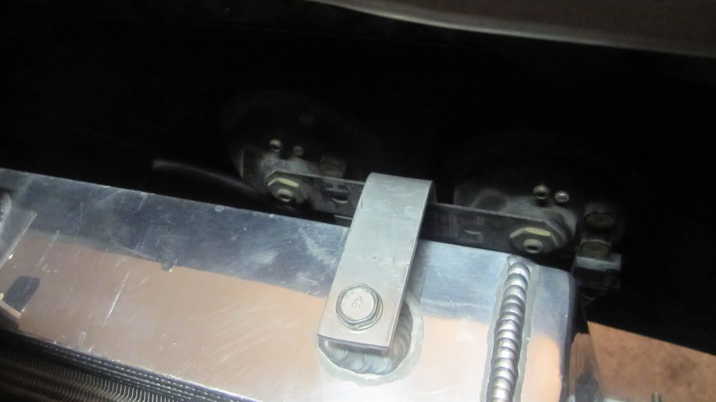

Here is how I mounted mine, But Im sure others will mount it more forward and take the grill out so you can see your cool front mount because thats the cool thing.. :nono: But I decided to keep my Bumper and everything in tact so I mounted it behind the bumper support. I had to remove the hood latch support and remount the A/C outside air temp sensor and horns.
This is the driftmotion kit
The simple bars I made for mounting on the bottom, literally took 5 min to make the two bottom and the top one..
Horn mount, Easy took another 2 min to make

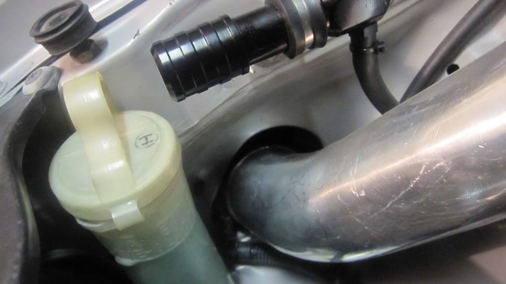

2.5 inch piping through the stock hole in the fender
Sleeper status front mount.. But the safest as I kept my crash bar
Overall mounting

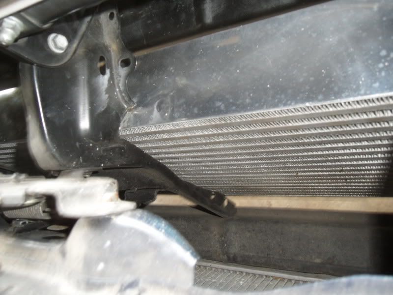

Im going to take pictures of mine for you. Our i/c's are very close to the same size and i didnt relocate mine.

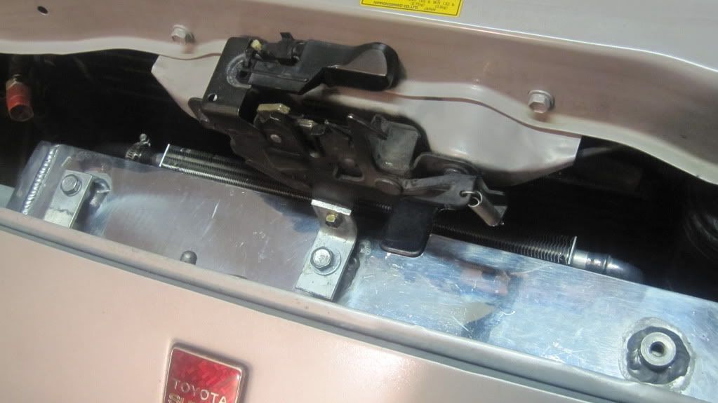

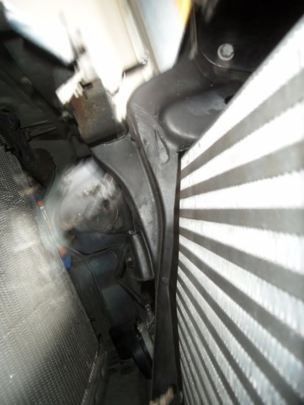

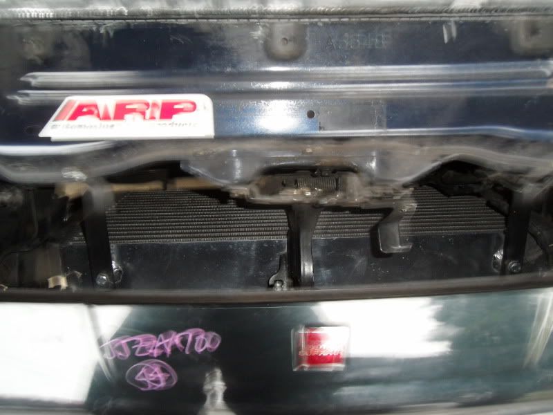

Ok this first picture isnt the best angle, but what has been done here is the big support bracket for the hood latch has been trimmed from its regular giant triangle shape.
This is so you can see how much it has been trimmed, and how close the I/C fits to it. This photo also shows how "steady" my hand is when cutting a straight line

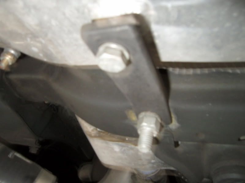

Mounting the top was done with some simple small lengths of steel, painted black.
As for the bottom, the same basic short lenghts of steel system was used. Both sides are exactly the same. Just to hard to get both in a detailed shot from the garage floor.

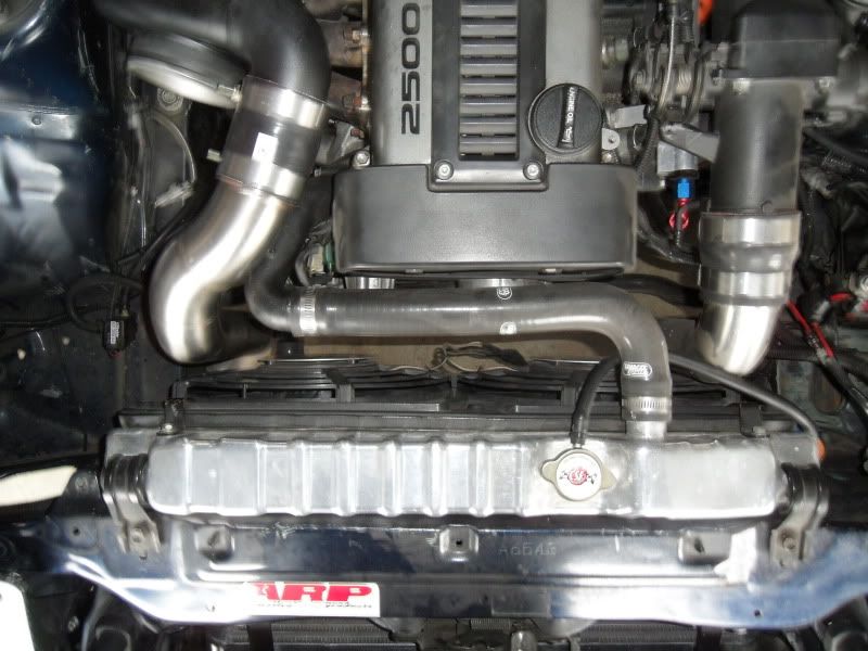

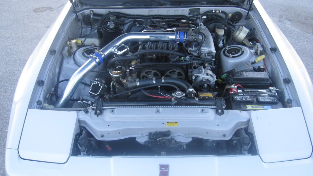

Now I dont know if this next picture will help at all because I've gone 1J. But this is how my pipes have been plumbed. Obviously it will be different for you if your 7M, unless you go FFIM
So that this:
Tucks up real nicely to look like this:
I like my giant intercooler to be hidden. Im all about the simple, close to stock look.
Tough to tell there is a large intercooler hiding behind that bumper, isnt it?
Now I hope this as helped, also you should note that I have removed my a/c. But I feel very confident that a a/c condenser would still fit in my set up, its just been a while since Ive though about the condenser and i/c in my car at the same time.
