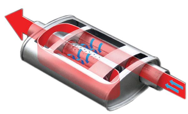

This is a turbo style muffler which I believe is the most restrictive performance muffler vs. chambered and straight through designs. It still rumbles at idle, and has a deep rumble when cruising. Under WOT conditions I can hear my turbo spooling over the exhaust. It's pretty quiet, except when my wastegate dumps to atmosphere. I think I'm going to re-route the wastegate dump back into the exhaust. I want to keep it as quiet as possible. It was cheap, and easy to weld up with a basic flux core mig welder. Welds don't look pretty, but it's functional.

Most restrictive? I would have thought they copied or had Borla make it as a generic label. As theirs is straight through. Most "turbo mufflers" I have seen are straight through with the mesh.

yeah 'turbo' are definitively an outdated design and so far ive only seen them used on 'well they said i needed a muffler' emissions deals.

oddly enough ive seen different 'turbo' designs.
one is an 's' shape in the housing
newer designs use a 'w' shape or maybe a '3' shape ;)
ive seen glasspacks called turbo as well but that could've been an error *shrug*
and these are designs coming from the 60's =/

thats a variation for sure but generally thats it ;) so many designs over the years its crazy

Yeah, they're not the most up to date performance style mufflers but it's going to get the job done. Like pictured above they look like this inside.
I wonder if it knocked me back a few ponies. We shall soon see as I have an itch to go back to the dragstrip. I'll let you guys know how it performs (or not) at the strip.

They can still flow a lot of volume, so I doubt you lost any jam. If so, it wouldn't be much.
Had one of these on my mildly modded civic back in the day and it did not lose any discernible power according to the g-tech pro.
