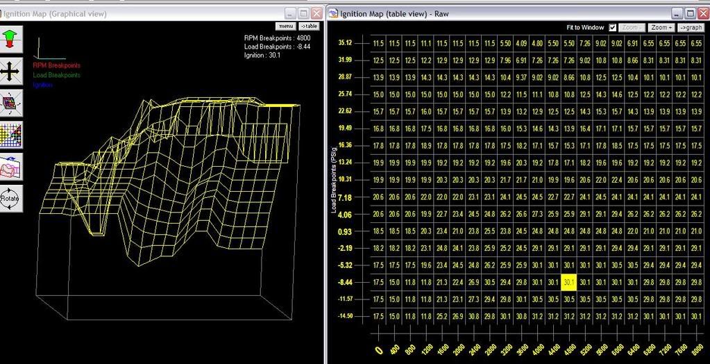

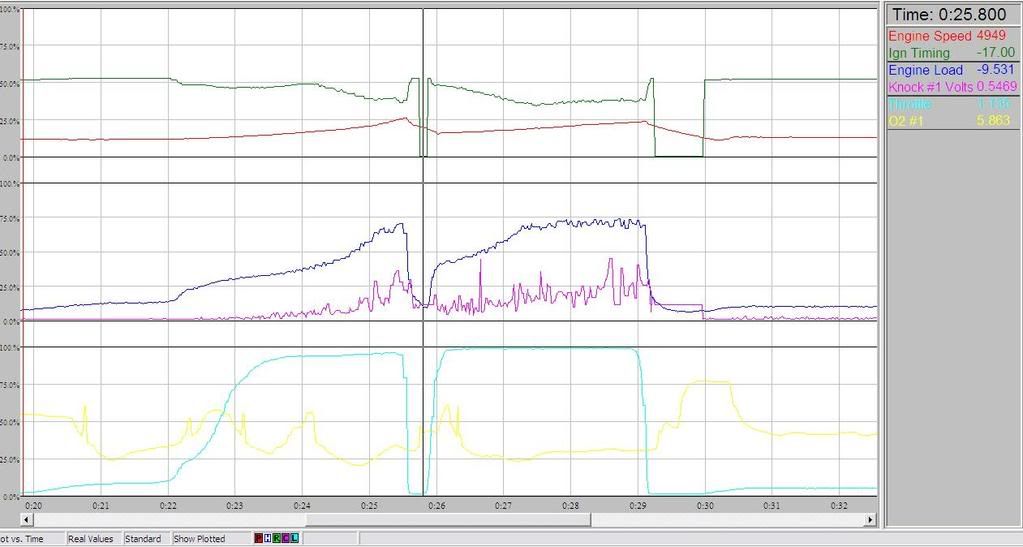

I was searching around through logs to see what would be making my tach stumble around at 3000 and saw places where my ignition timing was at -17. I still don't know what would be making my tach bounce around at 3000 or if it is even in the tune, but I would like to know if this -17 is normal..
Thanks

Thanks for the info, and as far as the timing dropping to -17 I think we figured it out. I have the 2 step setup for whenever I have the switch on and press the clutch (use it for power shifting at the track too). What I think it is doing is whenever I press the clutch to let out, it could still be trying to load the engine because the rpms are still up.
