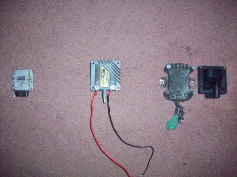

I have a 88 supra that Im attempting to wire up a 2jz-ge into right now but Im having some trouble with wiring up a few things, namely the igniter and coil. I have the one that came from the 2jz-ge and the original one from the 7mge. on the 7mge there was 1 plug that went to the igniter and then it had one coming out of it for the coil, easy enough. Well the 2jz igniter has 1 5pin harnis that attaches to it, so the questions I have are:
1) Where does the coil wire up to?
2) Can I use the 2jz igniter with the 7m coil, or should i go with the 7m coil and igniter?
3) if I can use the 2jz igniter with an after market coil?
(from left to right) 2jz igniter, aftermarket accel 140008 coil, stock 7m igniter and coil

they are both okay with any coil really.
Power the coil from the same wire igniter is powered from. Pin 3 on 2j one I think. They are all pretty obvious. The wires are igt to ecu, igf to ecu, coil - to coil duh, ig- to tach, power from key.
Have fun./

just to clarify:
Pin 3 of the igniter is the same wire to power the coil?
and the other 4 mentioned above are the other 4 wires that are on the igniter harness?

Yeah coil and igniter share the same power source. Should be a black/orn wire on pin 3. Check for power on IG2 key position just to be sure. the other 4 are the igniter connector. It's pretty much the same on all 90s single coil toyota stuff. tach is usually black and goes to ig- on diag box, igt and igf go to those pins on ecu, and the coil signal directly to the coil itself.
