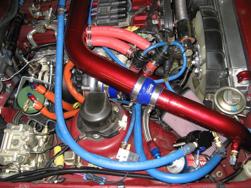

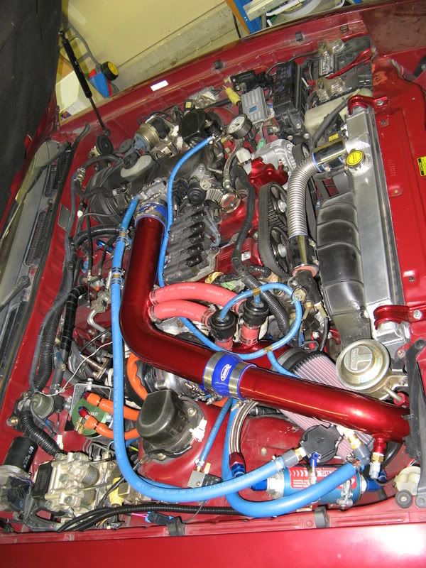

my ets ic pipes were in the way. so its temporary fix thats turning permanet. because its sturdy,works, and i dont really care what it looks like under my hood..to a point i guess.
That's pretty cool.
