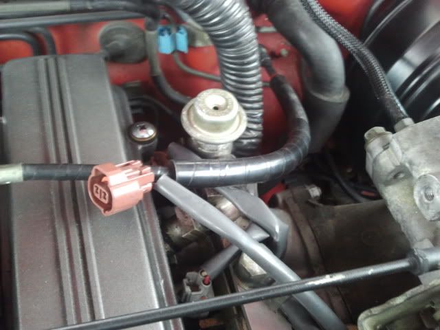

So there is one thing that i noticed today that could be the problem but i don't know. I have the stock FPR and i noticed that it has a hole on top of it. I thought there was supposed to be a small screw there in place for a factory adjustment. So i did a hot start today and it started missing and i took a small strait angle pick tool and pressed a tad bit and the car started to smooth out then went back to missing again. Could this be the problem?? Is there supposed to be a screw there?? Any help on this problem would be great. I have searched and searched about this problem for about a year now and making a thread is my last hope.

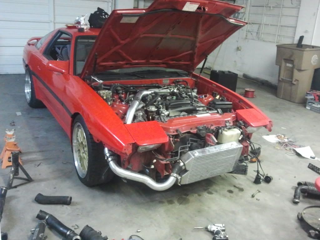

Second problem with my poopra. I feel like i have a boost leak problem. So i have been blaming it on those old factory soft pipes. So i ordered a kick ass FMIC kit from aaron at drifmotion to try and get rid of this problem. The top pipe keeps the stock bov i am using but i do have a extra top pipe with a knock off hks bov. I just did not want to install it yet until i get a real bov. So lastnight i installed the whole kit and it seemed like it got rid of the problem. The car felt way stronger and spooled much quicker. So i decided to put my manual boost controller on it today to try and get 10psi out of her. Well it does not seem to like it after 8psi. It falls on its face, but you can hear my stock ct-26 pushing harder. The old problems are coming back with less power. So i double and triple checked the hardpipes for any problems and everything seems great. Could it be my stock bov leaking

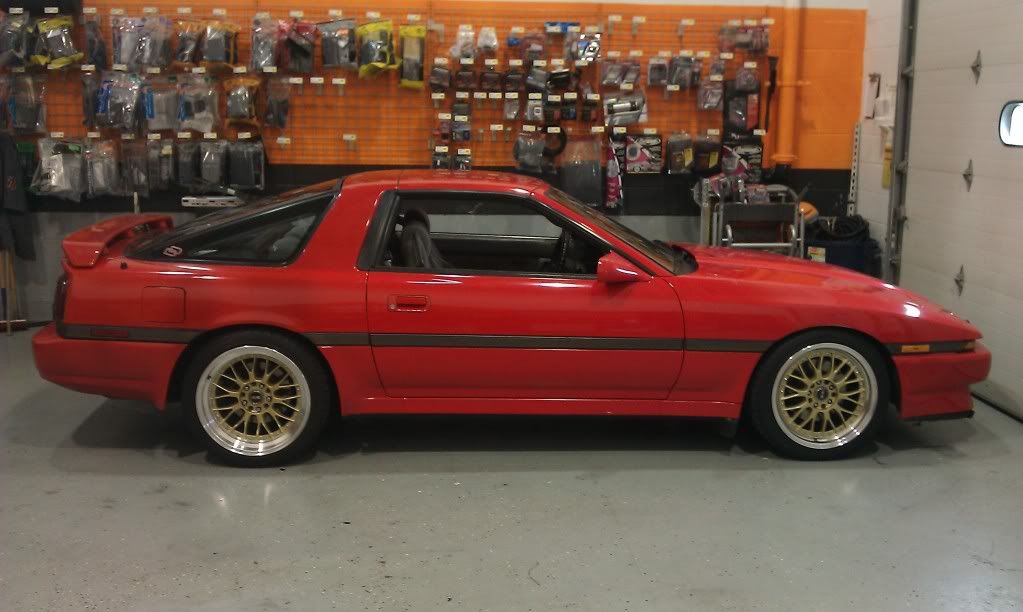

Here is my 88 supra

The fpr is in the front. The thing in the back is the pulsation dampner.
Hot starts could be caused by cold start time switch, improper vacuum lines, faulty vsv's, or lack of residual fuel pressure.

That *might* be the plug, but I don't think so. The VSV is nearer to the front of the engine.

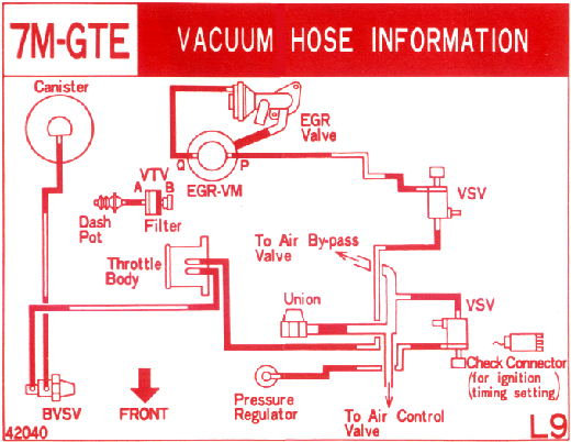

Can you post some pics of the front of the fuel rail where the fuel pressure regulator is? Trace the vacuum signal line on the FPR, tell us where it's going. It should be going to a VSV - a vacuum switch - and I suspect it will be plumbed directly into your intake manifold instead.
Another step to try... when it is hot and should be showing the symptoms you describe, pop the hood and remove the vacuum line to the FPR before you try to start it. If it runs properly, chances are this is the problem.

Thanks for the help! I will try this today and i will get some more pics up.
