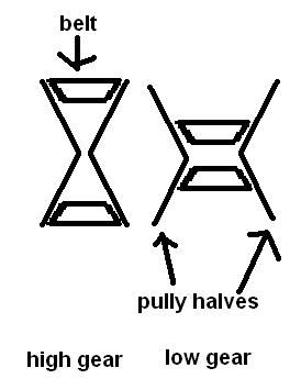

its liek a snowmobile, in a snomobile and go carts that are equiped they use a variable diameter pully. it uses a v shaped belt that rides inbetween 2 pully halves. as the rpms go up the pully halves get pulled closer together pulling the belt further from the center or effectivly making the pully diameter larger creating the change in gear ratio but no actuall gear change.
not exactaly sure if thats how its used in cars (with belts and pully halves) but thats the general idea.
EDIT: pic to further explain, the high gear low gear would be if the variable pully were on the engine or drive side, if it were on the axel, or driven side it would be oposite.

i did say that i wasnt exactaly sure how it was implemented but it is the basic idea. i just looked up the prius and its actually very interesting. i havnt seen pics of its exact setup but it seems as though it uses the planatary set and instead of holding one portion of it like in a conventional automatic, it varies the speed of one portion. to vary the speed of the others creating the variable gear ratios. pretty neat stuff.
