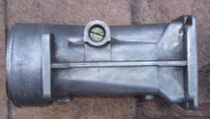

Here's a very detailed thread about how the lex/550 upgrade works. Interesting, but basically all you need to know is that it works..
http://suprasonic.org/lexusriemer/lexusnotes.html
Anyways, take a drill bit and drill this out. Don't worry about drilling too far, as you're just drilling out the cap. You'll feel it actually drill through.
After you drill through the cap, get something in there to pry it out. Once you get the cap removed, get out your dremel and grind a slot into the now exposed screw. It should look like this:
And anything else, here's a full install guide of the lex afm and all supporting mods:
http://www.mk3supra.org/topic/82-guide-installing-lexus-afm-550s-and-afpr/

There is a screw already in your afm underneath that little metal cap looking thing but u have to drill out to get to it. I used the biggest drill bit i could find and drilled in the middle. You wont damage the screw when u drill through because u will feel the bit get through the cap before it hits the screw. Theres about a half inch gap inbetween the two. You dont need to dremel as my screw already had an indentation for a flathead. Now, all that being said, you should do none of it lol. Leave it where it is and get a proper way to tune, safc, maft, etc. adjusting that screw and the fuel pressure in conjunction with a wideband is a very limited way of tuning. I couldnt get fuel cut to raise much at all or really any change in my AFR's no matter how much i played with it.
