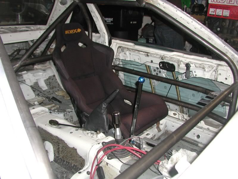

In drifting we set it up like that.. usually with a T into the rear brakes and a hydraulic E brake (Basically a slave cylinder with a long handle on it) Some of the time we do a dual rear caliper that has a separate system just for the Ebrake

Correct, That would be fine.. Here is how we have it setup on the drift car
