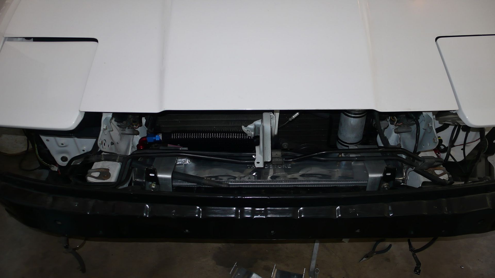

go to your local hardware store and get yourself some aluminum bar. It is fairly easy to bend with a vise, easy to drill, and is relatively strong. Hint: mock it up with cardboard before you start cutting and drilling.
Here's my IC mount (well, the top anyway):
