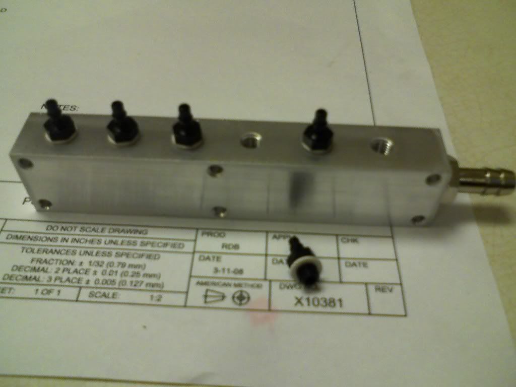

Are you sure no one else is running one vacuum port???? BTW I am for all other functions besides the brake booster and it is awesome. There is no problems, easier to route lines, easier to hook up aftermarket parts that need vac./boost. Plus it is easy to check for vacuum leaks. But I also have the brake booster running off of its own 1/4 npt port on the rear of the manifold. The extra ports Im not using yet just get capped off with no problem.
Also on the OEM manifold setup there is only 3 vacuum ports. One main one on the front of the manifold witch supplies the J shape vacuum tube, one small one on the rear for the heater valve and cruise control, and one for the brake booster.
Edit: here is a pic of the one I made. It is just zipped tied to the brake booster.

Well I have plenty of experience with the 7M and this way works good. Again the main thing is to have a larger supply to the vac. block in my experience. Plus if you think 15" of 3/8 hose to a vac block isn't a direct reading:nono: My readings are not slow or off at all.
Also if you study the 7M and it's oem configuration of it vacuum lay out you will find it is also all off of one vac port except non major things to run the engine (heater VSV and cruise control) besides brake booster but again that is a safety thing, and dosent contribute to how a engine runs unless it is leaking. The exception is the waste gate but it pulls it right out of the turbo and no need to run 5+ feet of vacuum hose when it is right there.
Last on the 7M things that don't need to see boost (like the VSV for the heater) they have there own inline check valves.

This is exactly what I'm looking to do and just do it right. If it's working for you then I don't see why it won't work for me. Thank you for posting the pic it really helped. Wish I coul've seen where you pulled the main source from but I think I can figure that out. This is awesome.
I'll still be looking for other solutions from anyone else but this is great.

You need to read better. I said 1/4" npt (pipe thread). That is a tap size for fittings that has a inside diameter of 7/16" and a 3/8" nipple at the other end. And 3/8 hose to lead to the vacuum block, witch to have it right needs a 1/4"npt tapped size hole.
Understand?
Also I disagree with your statement of "it is better to have multuple vacuum lines directly from the manifold". That is totaly ludricrous. Think about it ;)
