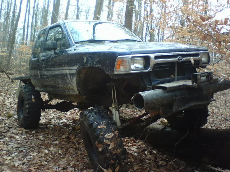

I want to build a copy of jolirogr's truck, only with an r154 JZ, t70 and the ability to be street driven (4" exhaust out the fender does not make it street friendly). With all that ground clearance, I have an idea on how to make a 4" exhaust that will allow it to pass emissions, flow better than a 3" and be insainly quiet. :) 2 cats, 2 mufflers, 2 90* bendsand around 4' of strait pipe. If I can find a truck at the right price and in the right condition, I would pull the setup out of my supra in a heartbeat. Rofflpwning people in a toyota truck = win.

I have a yota with a 4.1gm with a built th350. its for sale. only 1k. i also have a tow rig for my supras. His name is Boosty. im running 40psi
