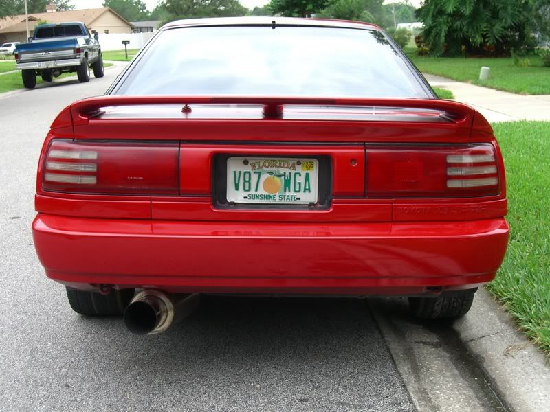

3in Straightpipe turbo back

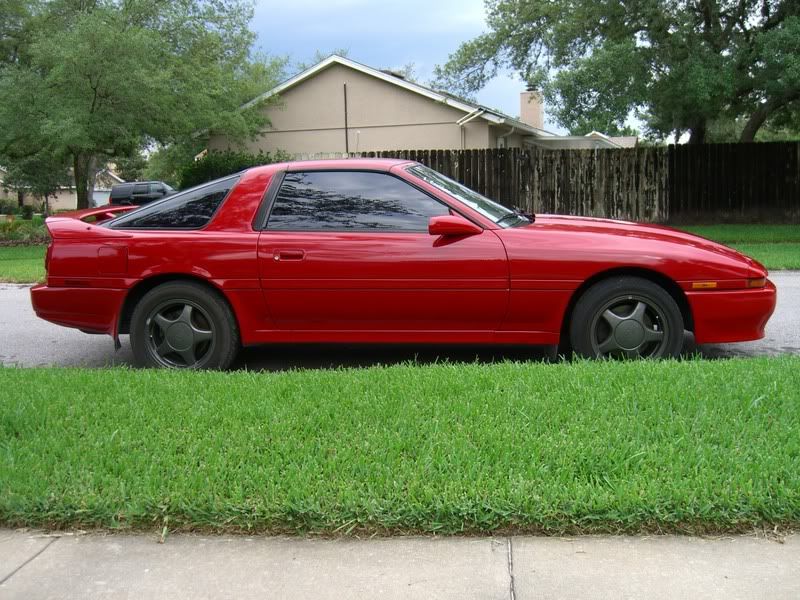

No PCV valve on hose. Car has been repainted also.

Anyway.. car looks nice.. just be careful with it
