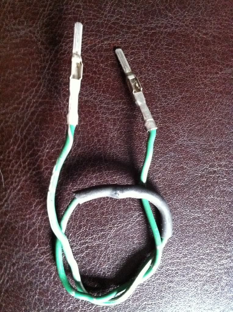

This is the only diagnostic tool we need:
Speaker wire works just as well if you have some lying around. ;)

Take apart a connector from a junk o2 sensor and make a proper jumper tool. Paper clips are for amateurs.
