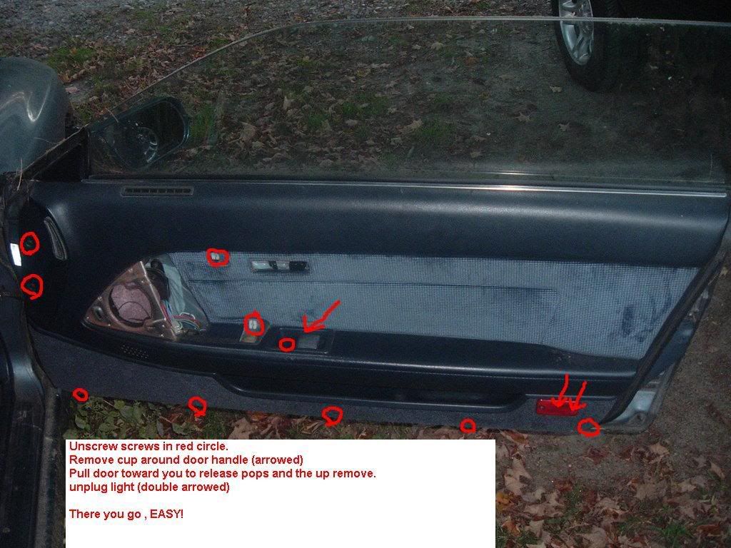

screws . Along the bottom , two in the handle, one in the door release cup, two with caps near top hinge side. Unscrew all screws then pull from pops then lift up to get the lip detached from the window edge. I'll try and find some pictures. Oh and don't forget to unplug the door light before completely removing the panel
