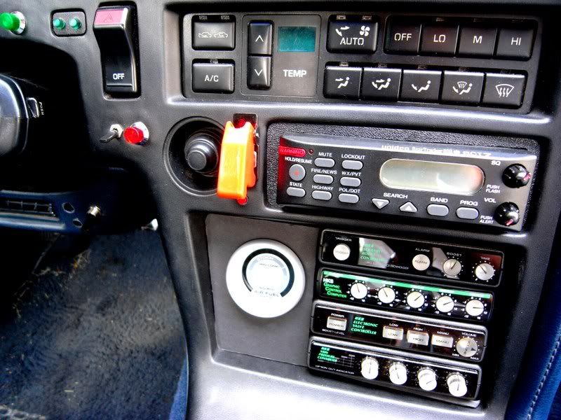

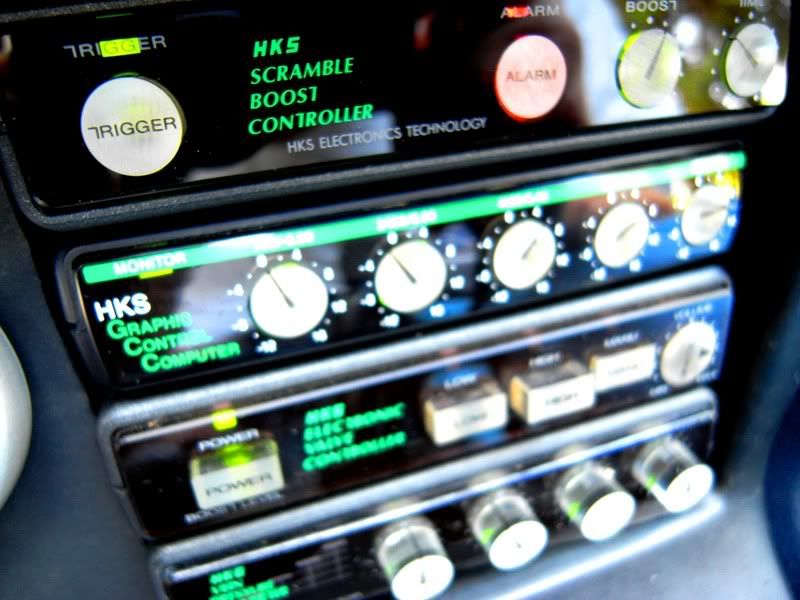

Here's some of the setup:
^^^ The SBC (Scramble Boost Controller) is the Cats Meow! A whole story in itself!:biglaugh:
Also running HKS IC and plumbing and the SSBV and 550cc's from HKS too.
Still hoping to squeeze pretty close to 500whp out of this... so I'm wanting to model those who went there before!:1zhelp:
-crisp
