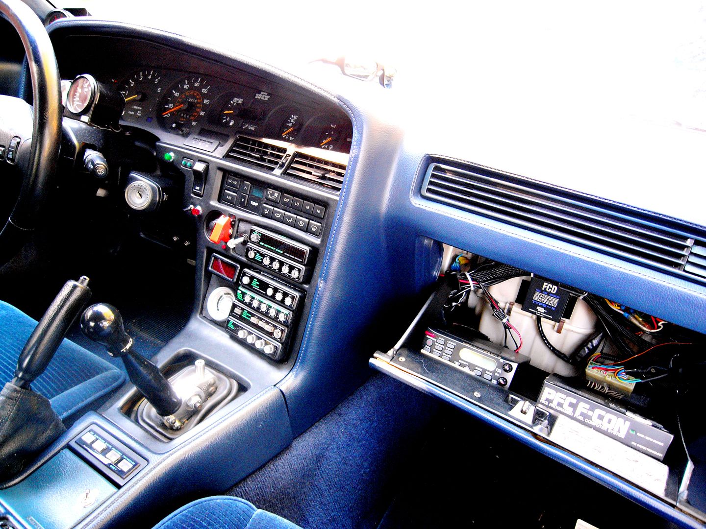

I would follow the HKS PFC F-con manual for how to run and set it up. I have been running HKS alphabet for about 16 years, starting with JUST F-con AND FCD on stock injectors and chip. Now I'm ALL the stuff, 550cc and still have no issues after MANY years and various combinations. I STILL run the FCD in my setup.
Hope that helps. Hit me up if you don't have access to the F-con manual and instructions.

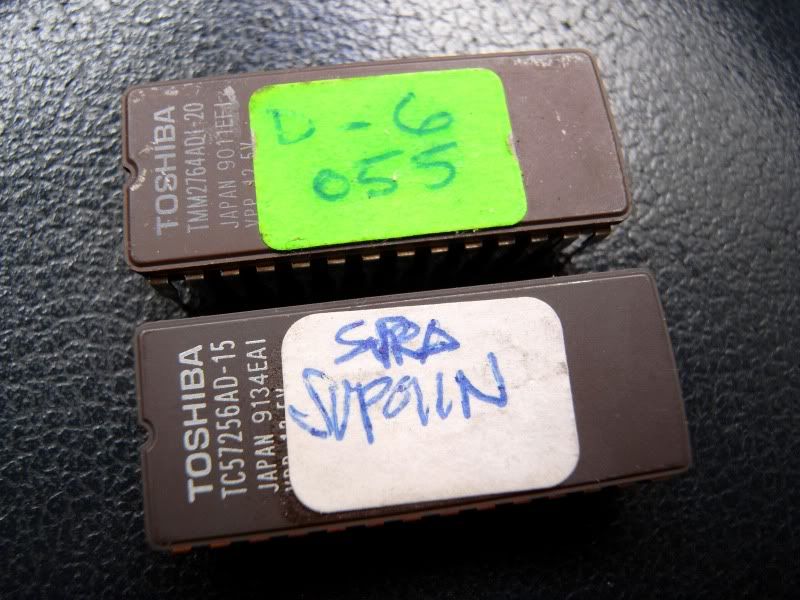

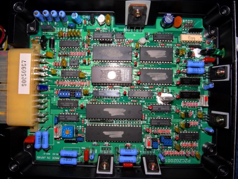

And just to make sure, the chip in my fcon says D-1055. This is the stock injector chip right?

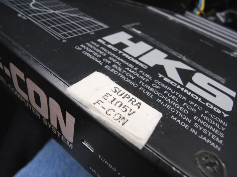

Hmmm... the E105V is what I'm running now with 550cc and the VPC. (Sticker is on the F-con housing instead of the chip inside. Easier for reference. I can't remember how the rest goes, but I think in my case the D-6055? was 440cc injectors original setup.

Just looked at it again, closer this time, the 1 is actually a 6. Its just kinda washed out looking so it was hard to see at first. And the TMM2764 number on mine matches yours so its gotta be the 440 chip.

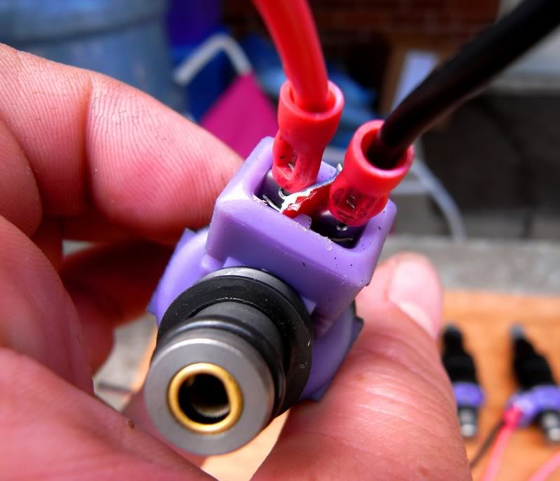

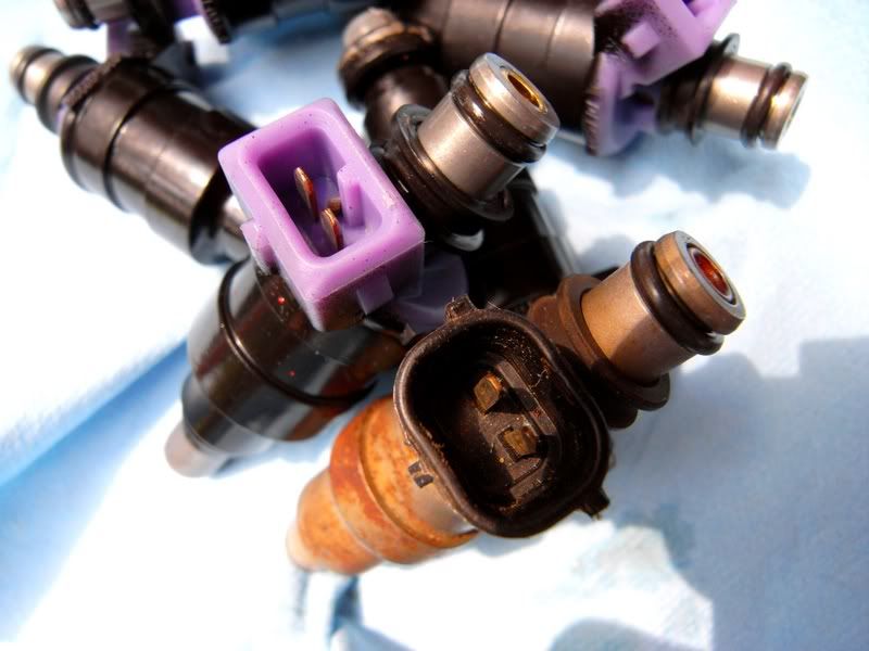

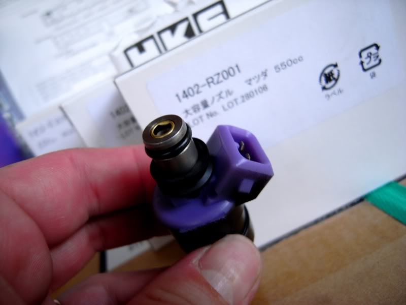

^^^ The RX7 injectors ARE what HKS ships for their 550cc injector part number now. They used to have a unique HKS licensed part, I believe, but now commonized with the RX7 injector.
Something like that...

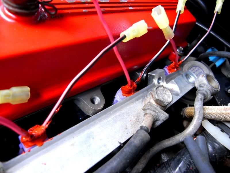

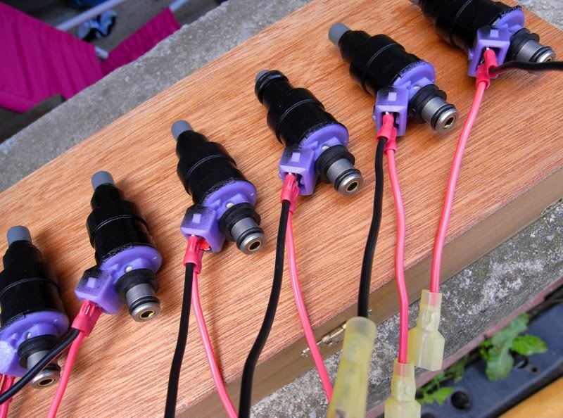

NOTE: The white box in the first picture says "MAZDA" in Japanese just in front of the number 550cc. Also, DON'T rig your setup the way I did... as pigtails are available to make these work with stock harness! NO NEED to cut it up and get as "creative" as I did JUST to have it up and running THAT FREAKIN' DAY!:biglaugh:
...although... my rigged method has worked FLAWLESSLY for several years now...;)
