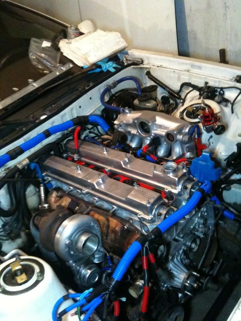

Here is my engine bay. What is safe to use for cleaning it?

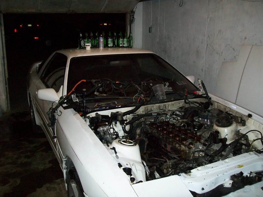

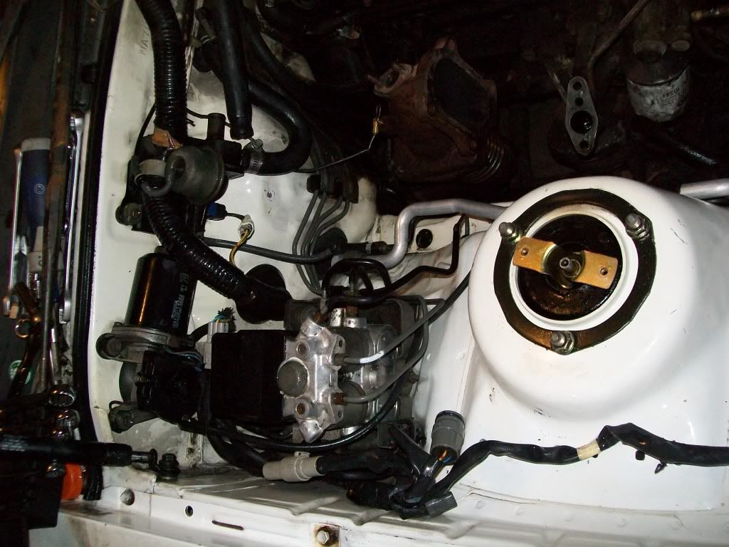

i cleaned my whole engine bay with purple power and a tooth brush...it worked great!
before
after
now i used it in pure concentrate and after cleaning an area id quickly hit it with a spray bottle filled with water and wipe it dry...it didnt hurt any paint or aluminum aslong as you didnt let it sit and soak...
