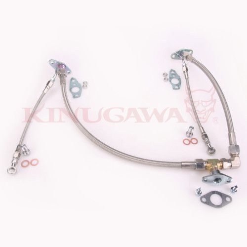

Well seeing that no one knew the part #s, and I can't find them. I went another way. Here is what I came up with.
I still need the 2jzgte - alternator harness plug.
