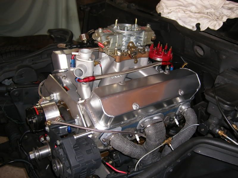

OK you know the plug that goes from the igniter to the coil pack, well i had that plugged into the harness and from the harness to the igniter....... i had them reversed lol
dude i ripped my my harness out swapped everything all day n couldnt figure it out.
until...... i had me a nice cold beer and sat there n stared at the motor for a good 20 min lol n im like damn these two plugs are the same shape i wnder if i switched them up. booom fired right up :)

Tomorrow morning, im gonna be buttoning everything up! motor looks cluttered up onlybecause i was trying all week to figure out my spark issue! but ill have pics tomorrow and maybe a test drive video :)

Hey whatsup guys, im having a few issues here that ive been trying to work out but i just cant seem to figure ANYTHING out.
My project that ive been workin on for the past 2 years is almost done, and im not sure if im missing something here or what, my setup =
built motor
th350 trans
FFIM
Removed ABS
Removed Cruise Control
This is a 88 turbo harness and used to be a 5sp.
problem #1
These two wires are coming off of the main harness near the injector clips.. anyone know where they go or what their for?
Problem #2
What is this? the mini plug there!
Problem #3
The car does not get any spark, no matter what i do. i have done the following
Tested my ingniter (good) also swapped a known good one in.
Tested my coil packs (good) also swapped with a couple known good ones.
I have new plug wires
new spark plugs
It cranks strong but will not start due to no spark. im running out of ideas here and im really pissed i cant get my new motor to start.
also does this seem ok
I have a decent gauge wire hooked up from chassis to the block. is that necessary!
I never ask for help cuzz im usually really good at workin on our cars, but this one is blowing my mind.
any help is greatly appreciated.
