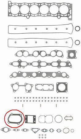

The following is a pic of the fel-pro head gasket kit for the turbo supra (part# HS9473PT-1), I want the gasket that is circled:
Toyota describes it as "gasket, turbine out", part# 17279-42010, and they want $81.88 for it. I'm looking to pay less, but monument, kragen, autozone, and rock auto don't have it. Ideas?

The whole turbo gasket kit is like $80
Go with the Toyota kit, it has ALL the turbo gaskets.
I dont know about aftermarket.
