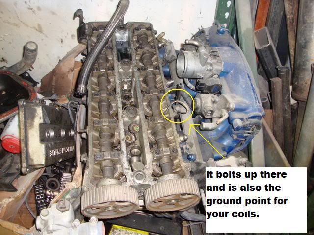

Does anyone know where this part goes on my 92T? I took am putting everything back together after fixing a bhg but don't remember where this goes. I've attached a picture of the part, it's a line with a bracket and vacuum hose on each one, one hose is curly.

next time, use a bigger picture. From what I can tell its part of the vac system for the U shape hose underneath the intake mani and the other is for your BPV and also runs from underneath your intake up to the 3000 pipe

I would say the bigger pipe bolts to the head near the coil pack, and runs downward under the intake manifold to the vacuum tree. I have 2-3 of the bolt with attached nut to bolt it on with, and could get pictures if nobody posts a link ( I had that bookmarked until my computer died).
The U-shaped hose looks like it should go from your turbo to your wastegate.

that is the hard pipe and hoses that go from your blow off valve to your intake for vacuum.
