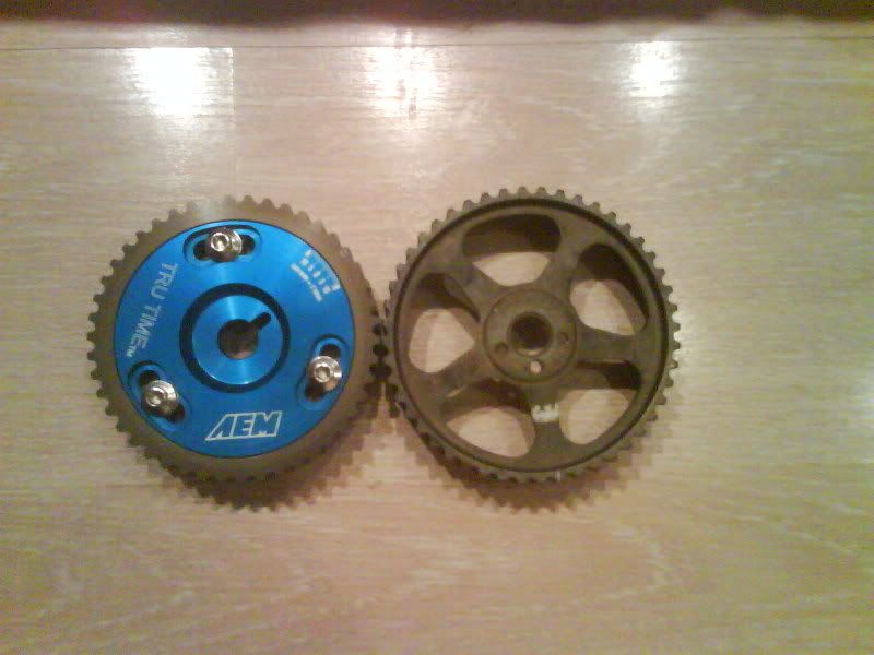

Having trouble changing my timing belt. I'm using a Gates Racing one and have read the TRSM bit but I always come out with too much slack around the tensioner with the tensioner released

pretty sure its the right belt but will check in the morning. As for how much slack enought to throw the timing of the cams out buy about two teeth every rev.
The tensioner is as far right as possible

the tensioner can only move so far. as far as adjusting, i believe the hole in the pulley is slotted, but not really adjustable.
if there are lines on the belt for position of the cam gears and the crank. those are only for putting it on. after any revs. those lines wont line back up again.
put it on, turn the crank over a few times, stop when the cam gear notches line back up with the backing cover (straight up). then look to see where the timing mark is at on the crank pulley. if its not at zero, then somethings messed up. (wrong belt would be my guess)
with the belt on, try and pull the belt off of the cam gears, it should very hard if not impossible to do.

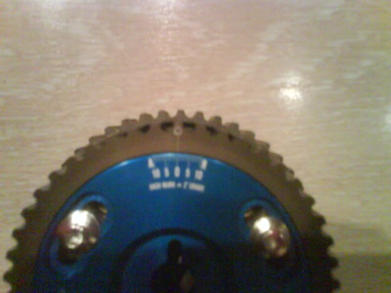

Well the answer is wrong cam gears. I bought some AEM adjustable ones from supra sport but they are smaller than original.
I was a few months ago since I got them any change of getting a replacement.
What gears do I have?

I am checking with AEM and waiting to hear back from them right now. Just to clear it up for everyone...the box does say its for the 7mtge and it was sealed. If the wrong part was/is in the box it was not SupraSport. We are checking and doing the basics right now to getting it taken care of...the issue they are having already is the time that has elapsed, and you being overseas. I'll let you know what I find out. Could you also measure the shaft size...were the pin goes not the side with the teeth

cant measure it now as its dark but the centre is a perfect fit for the 7M's cam thats why its taken me a while to relise its the wrong one.

sorry to hear. do you still have your stock cam gears? I would return the AEMs for a refund if you can, at least with the stock gears you can get the car running.

Because of the elapsed time they want a picture of the wrong cam gear, a pic with the stock gear, and a pic of stock only gear.
