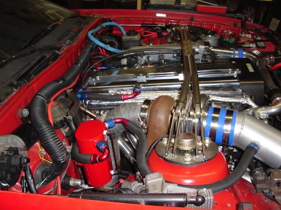

i was thinking about bending some stainless sheet metal for this.i have the rhd heat sheild you mentioned and a catch can bolted there.

i don't really think it would because the vented gases are warm anyways.i have some other stuff i'm tucking in that corner of the bay

tsuper92: Uhm, in that pic, do you have the heatshield installed?! I've only seen it a few times, but if it's there, I thought it'd shield more area than that....
