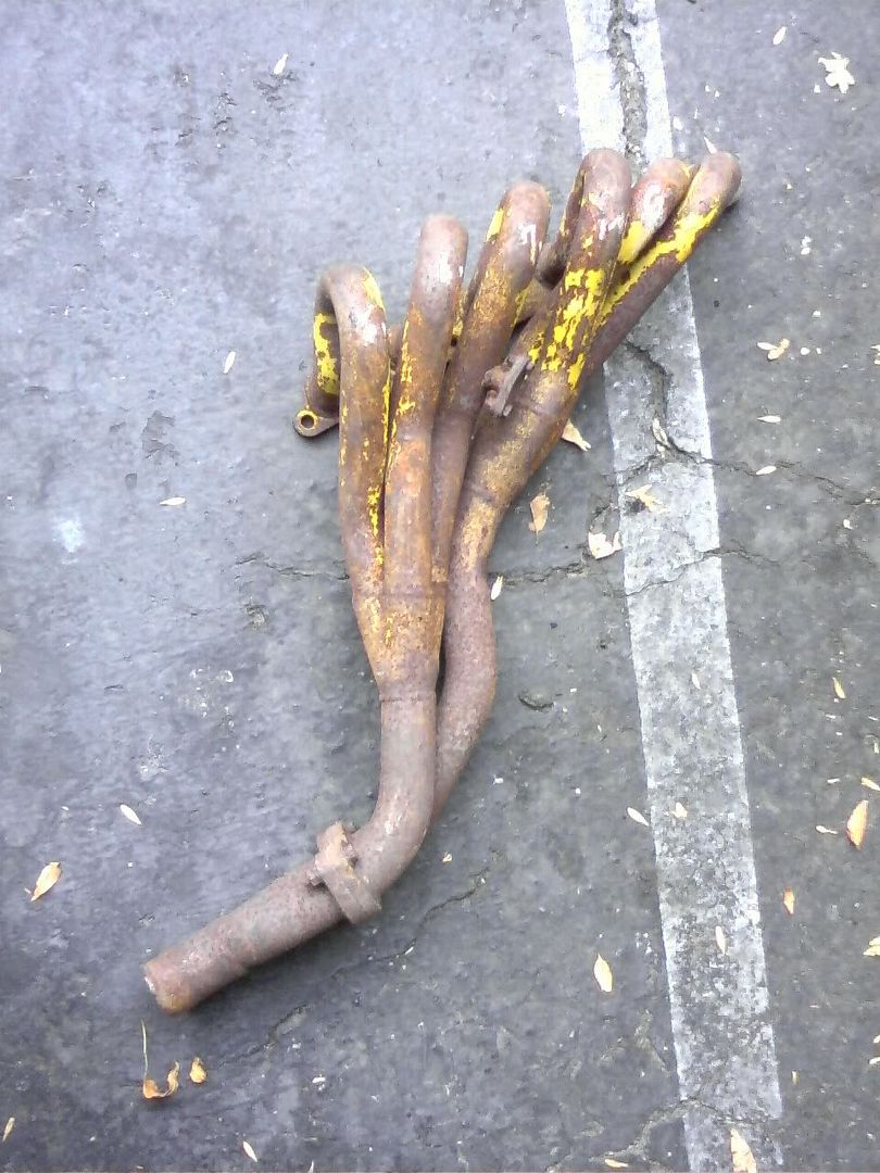

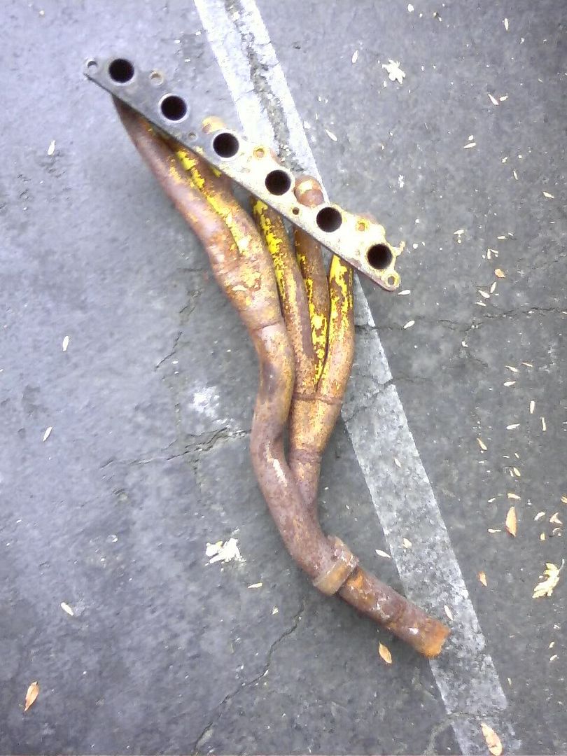

Tanya;934182 said:
TRUST header
1 5/8" inner diameter. My only gripe about the design is where the O2 sensor is located, but that can be easily modified.
Only sold in Japan, you can contact Greddy USA. There is no part number listed for the 7MGE, but if it fits a 5M, I assume it'll be fine for the 7M as well.
http://www.trust-power.com/01exhaust/tr_na_mani.html
MA61 part # 10510550
I was quoted $525 shipped to my door from Greddy in NY (when I lived in NY)

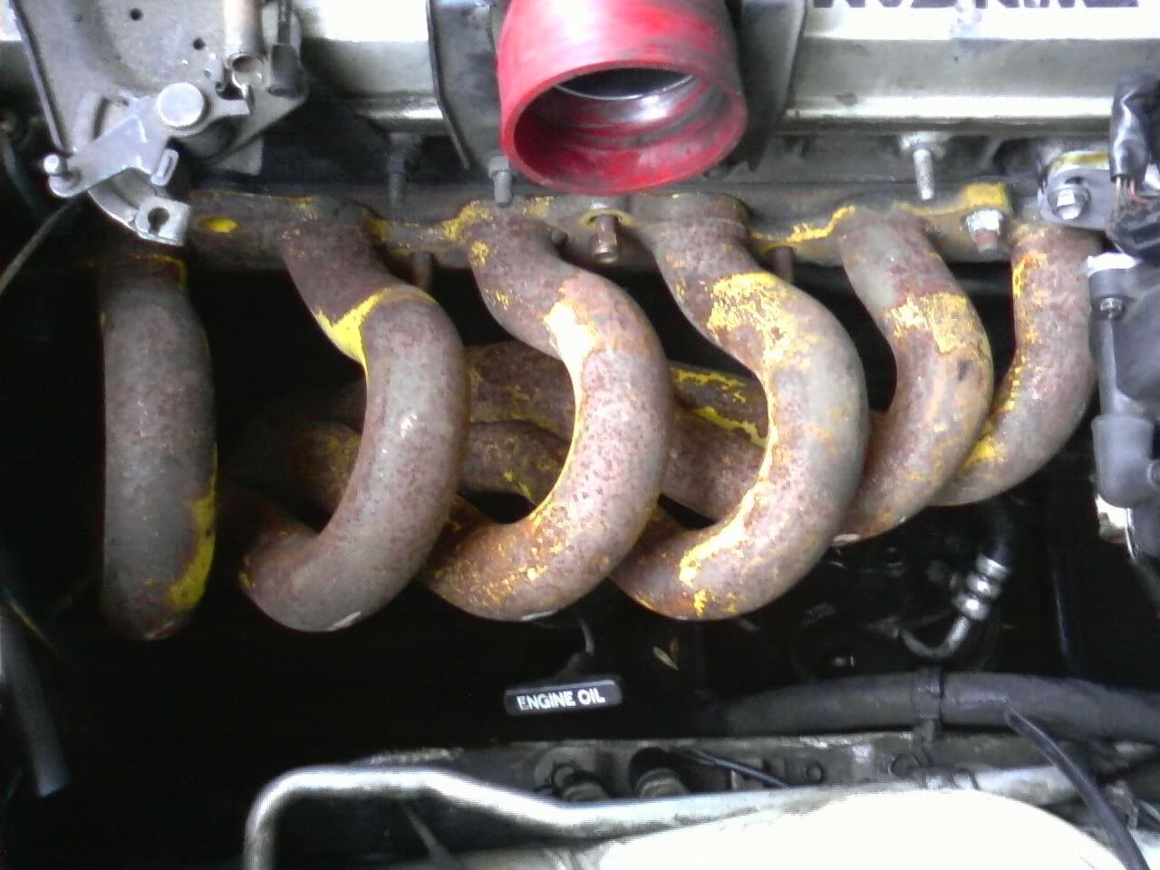

Those Trust headers look awfully similar to the HKS Headers I have. Mine are originally for the 5/6M but fit perfectly on the 7M.
How did you come to find out those were HKS headers? Is there a marking on them of any kind?
I've seen Greddy/TRUST knock-off headers on yahoo Japan, painted in that same yellow color.
A-to-the-J
Panda™ and Pre-89 Gracer™
Feb 19, 2006
1,081
Anaheim/West Covina, CA
It was stated by our engine supplier. Plus the engine it was on had a bunch of other HKS goodies, so there was no argument. But from what you say, i guess it might be possible?
pm'd.
