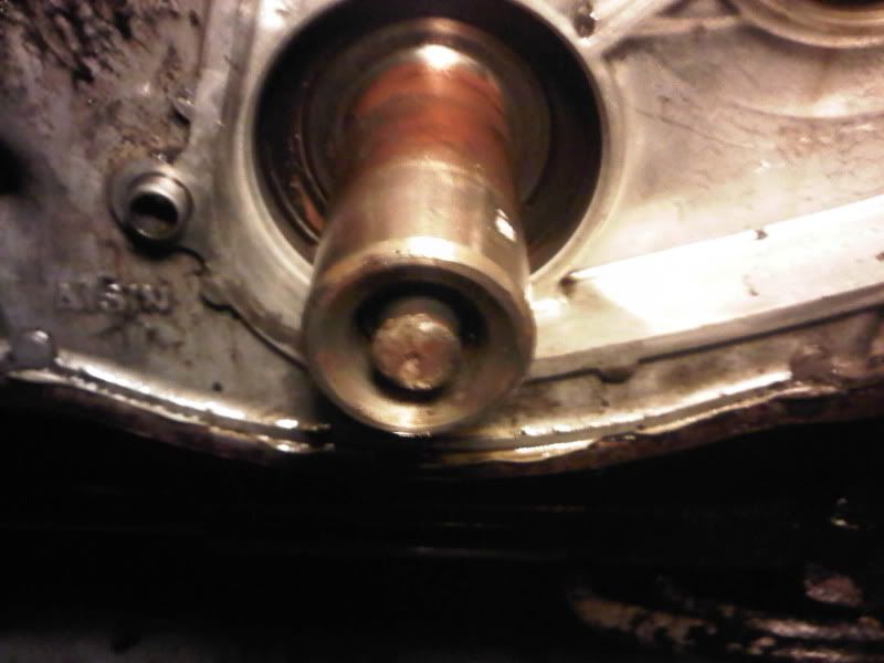

Hey guys,
I used the starter method to get the harmonic balancer bolt off and guess what, it broke, lol. so, my question is has anyone experenced this before? Whats the best possible outcome? tips, tricks, tools needed to extract that bolt?

Drill a hole in the crank and then get a stud extractor and use it.
You can also get someone who has a welder to weld the bolt back on. Gas or tig welding will be best there. Then soak the bolt with WD-40 and try to get it loose with the car in gear and a 1/2 breaker bar.

Yes, we've seen this before. It's no fun getting that out without pulling the crank, but it can be done.
Problem is, that bolt is hardened steel, so drilling it isn't going to be fun. And chances are it's going to be stuck in there good enough to break any extractor you try. Some good thread penetrating oil is highly recommended, and let it sit for a day or two, you might get lucky.
Worst case, you can have a snout machined that fit precisely over the end of the crank, with exactly the right size hole in the center, use that as a guide to drill out the bolt. That's what we used when Duane's engine decided to weld the stock damper to the end of the crank... it took forever, but it worked.

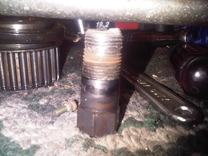

ok guys i got the damn thing out! after breaking 4 ratchets, buying a extractor set (which didnt work) i ended up having a stud extractor that fit. I hooked it up with my 4 foot breaker bar with my wife holding the brakes and it came out! I did heat it up for about 30 mins with my little propane torch.
Threads were all mauled, so with that said, anyone know what size tap i need for the crank shaft?
