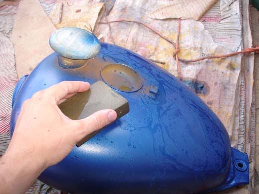

Step 3 - Wet sand back the surface until it is smooth. To wet sand:
- Get a (or several) medium/fine wet sanding sponge (Wilkos ~£1)
- Dip in water and then wipe it over the surface a few times to build up a film of water
- Sand the surface as normal but regularly stop to dip in clean water
The water will prevent cutting into the surface and give you a much smoother finish but it takes a lot longer to smooth down so if your area is badly damaged you might want to dry sand it first. One side of your sponge will be medium grit (which isn't as coarse as it feels when you have a surface of water so don't worry!), and the other is fine. Start with the medium then flip over to the fine side

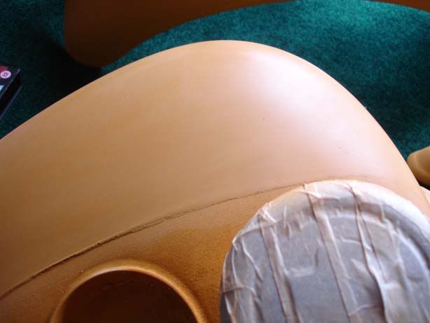

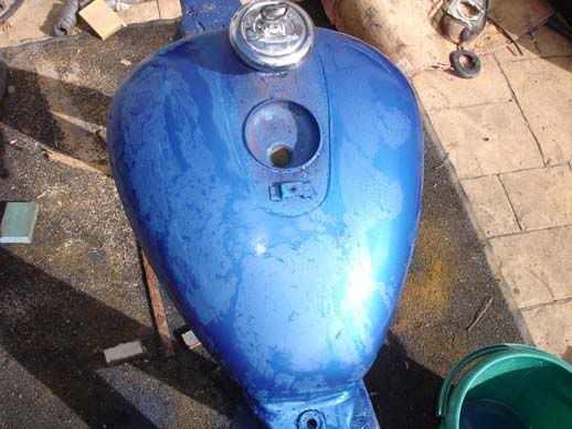

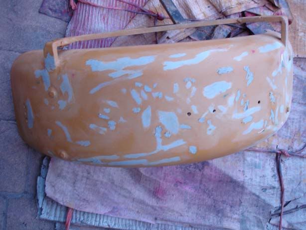

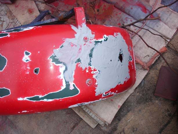

Step 6 - I'm not going to cover filling large areas but I did need to use a substantial amount of 'stopper' which is a fine surface filler. Basically this can be applied to cracks, dints, chips etc anything small that is going to show through the finished surface. The first picture shows the most substantial area I covered which was a large lightly pitted area, it almost warranted the use of a P38 style filler but the stopper is actually a very fine layer so I decided this would be adequate. Try and apply your filler in an even manner and smooth the edges where it meets the paint - Oh, use your finger for it because you'll be able to mould it properly and smooth it better than anything else you can buy

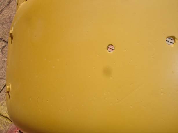

If necessary, build up the stopper/filler with several layers (Shown in picture 2 with one layer applied. In this case standard filler could have been justified)
NOTE : When stopper starts to dry (Very quickly after you apply it) you won't be able to re-work it so apply it at a steady pace and don't get ahead of yourself. Work a small area at a time and concentrate on making it as smooth as you can. Saying that, don't get carried away - you'll be sanding it to get the finish you need and if you keep prodding it then it'll start to solidify and rough up the surface (If this happens, move on to the next part and don't touch til it dries)

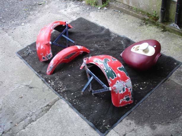

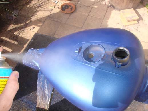

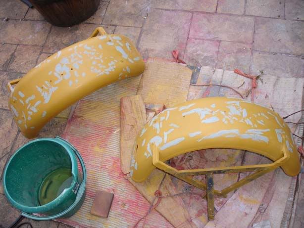

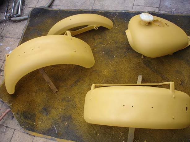

Step 9 - Lay your part(s) out on a surface (picture 1) you can afford to get paint on and start shaking your tin of primer. Mix the paint well because you don't want colour imperfections or inconsitent spraying. Start to spray ...
Spraying :
1. Keep the aerosol min 20cm away from the surface. Seriously. Don't be tempted to move in close because you WILL screw up the finish.
2. Move all the time - if you hold the can still you will have massive build up of paint and it'll look crap. Constantly move across the surface in long sweeping strokes. Don't point the aerosol at the surface then press the nozzle, start spraying before you are over it and then spray evenly across the whole part until you pass over it completely

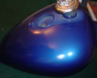

3. Do lots of very thin coats. If you start putting a thick coat on it'll look awesome ... for about 10 seconds until you realise you've got high/low points, running paint (drips), and just generally a bad result.
Have a look at the fuel tank in the second picture. It gives you the best idea of how thin the coats I put on were.

Step 10 - Go to 9 for at least 3 or 4 coats. I decided 8 coats to start with, then some more stopper/filling then another 8 coats. That's just the primer of course. Hycote stuff allows 10-15 minutes between coats so within a couple of hours you can have built up a nice covering. Afetr 8 coats it'll look something like this:
(Note the use of rocks - make sure you get all the edges as much as you do the main surface of whatever you paint)

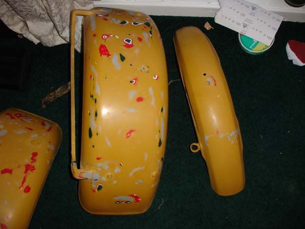

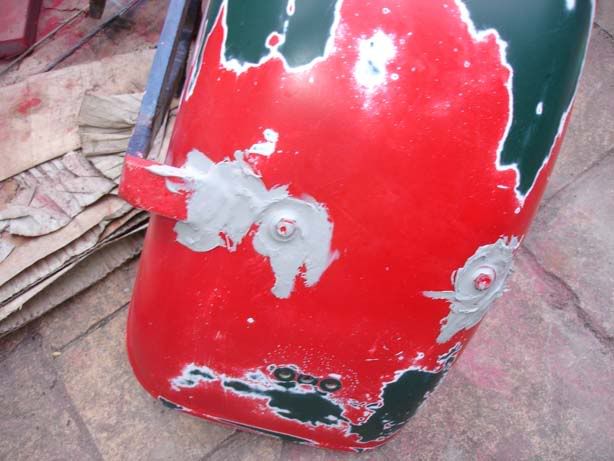

Step 13 - Get busy with the stopper, don't skimp and make sure you get all of the imperfections. Now is where you build on your earlier work, don't see any stage as a waste of time - you have to have some patience to get an excellent end result.

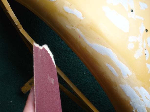

Step 14 - At this stage I treated it like I had just started the arch, I got some normal medium grit sand paper and roughly smoothed down the surface of the filler so it was pretty much a flat even surface across the whole arch. Don't press too hard or sand too deep unless you want to get filling again! It's much easier to take off filler than apply it so go easy with the dry sanding

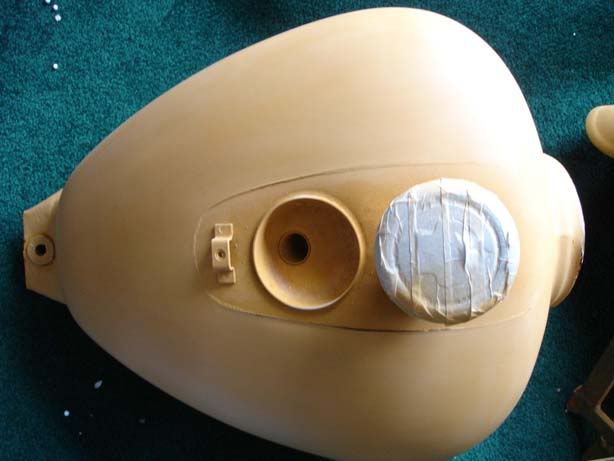

Step 15 - Once rough sanded, the surface will look something like this
Step 16 - Once wet sanded and clean it'll be more like this

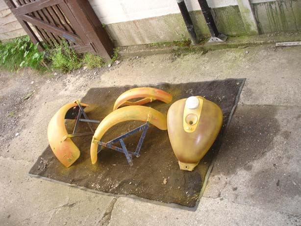

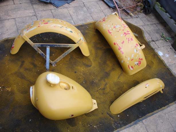

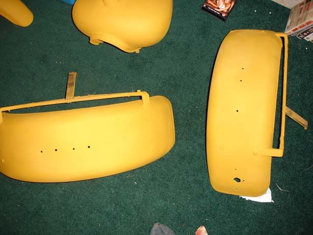

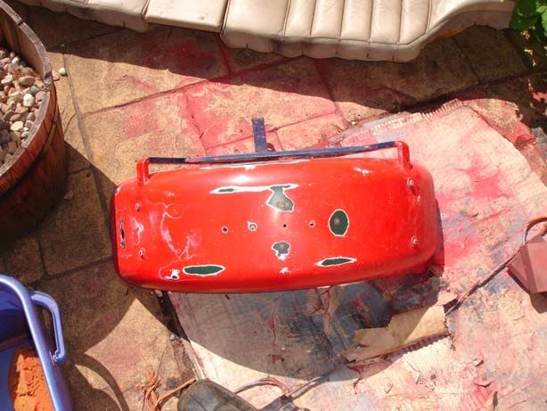

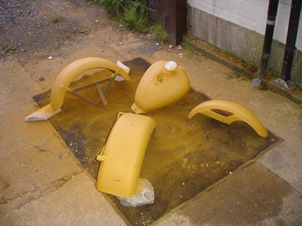

Step 17 - I'm now going to switch between panels now, I had some pc problems which mean I have less pictures than I'd have hoped and this will let me demonstrate things more easily. Here's a picture of the state of everything so far, all has been prepped to the same level

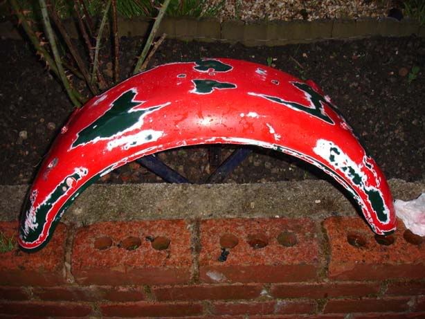

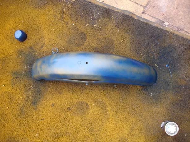

Step 23 - Start applying your top coat. I've showed a pic of the front arch here because it bests demonstrates how patchy the paint is allowed to be. Don't 'colour it in', just apply an even layer over the whole surface and don't worry about the patchy look. Keep the aerosol at a fixed height above the piece you are spraying and don't stop moving.

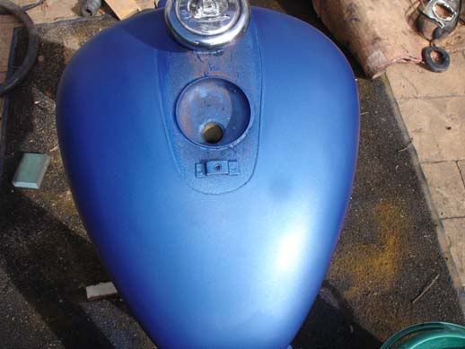

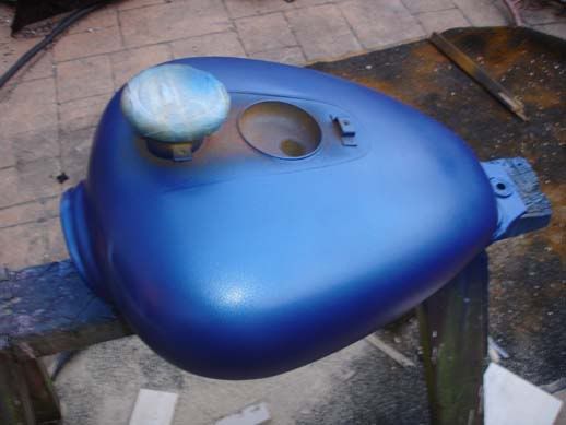

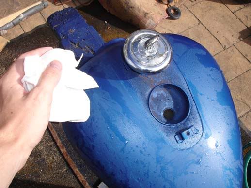

Step 24 - After 8 coats of top coat, the fuel tank looked like this

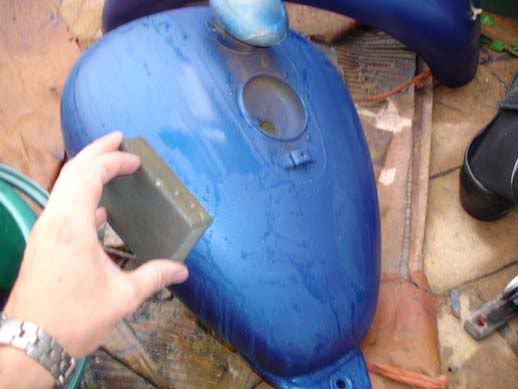

Step 25 - You see on this picture that the surface was really mottled and bumpy so it gets wet sanded smooth. I do this half way through the top coat spraying so we end up with a nice flat finish by the end

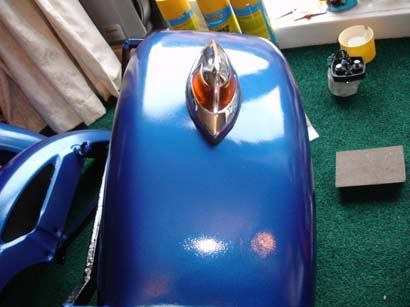

Step 26 - Another 6 or so coats later and it's like this

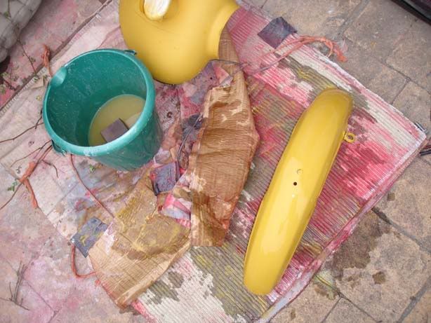

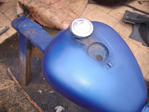

Step 27 - Another wet sand to get the surface finish we are after
Step 28 - Always dry the bits off after wet sanding with some clean kitchen towel. This will prevent staining from watermarks

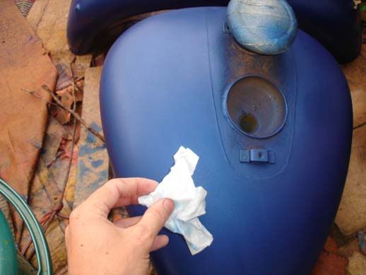

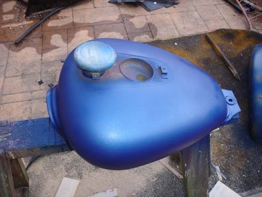

Step 29 - Sadly I lost a lot of pictures here but I find the key to lacquering is a two stage process
1. Apply about 8 coats in the same manner as when you spray top coat (First picture shows after this stage is reached)
2. Wet sand it back and it'll look awful (See picture 2)

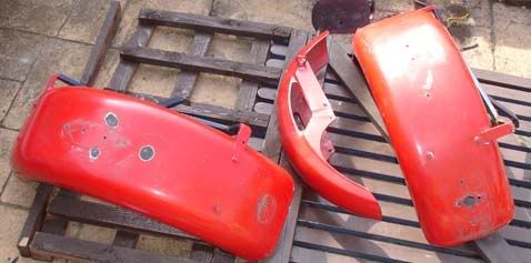

3. Wipe it down with some kitchen towel (will start to look much better) - see pictures 3 and 4
3. Now you need to spray again and give a further 4-10 coats (I did about 6), this time you do it differently though. Move the paint can so it is SLIGHTLY closer to the surface (If you were 20cm away, go to 15cm for the lacquer), spray as before with the can constantly moving but making slow sweeping movements so you leave a thicker layer of coverage. Picture 5 shows roughly how far away I was. The key here is to have a constant slow movement so you get a really nice distribution but a thick enough coat of lacquer so that it doesn't leave the rough surface you got with the top coat.
Hycote lacquer is excellent, some are very poor for dripping and poor spray patterns but this stuff is highly recommended. You shouldn't need to sand the lacquer once you have applied your last few coats and all being well your stuff should look like this:
