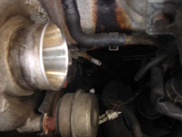

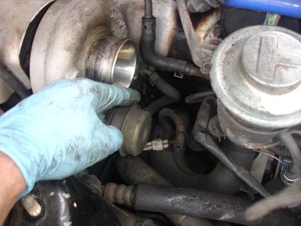

Step 3 - Locate the hose from the turbo to the wastegate actuator

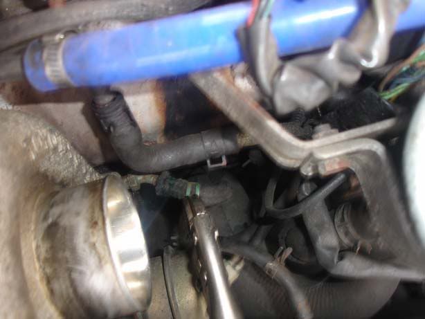

Step 4 - Use a monkey wrench to remove clips from both ends of the hose

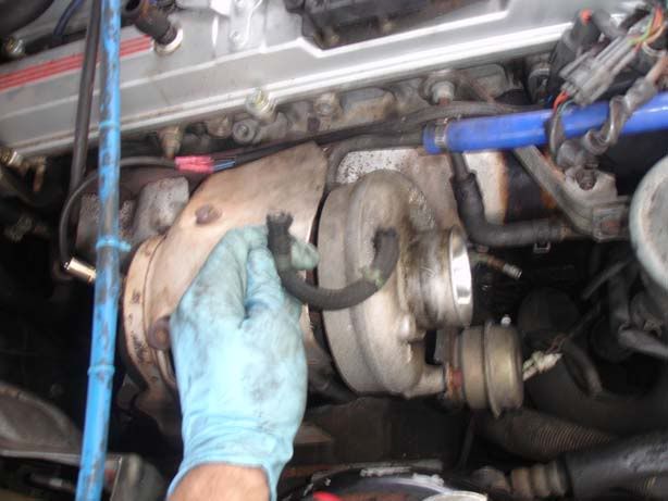

Step 5 - Pull the hose clear of the car
Step 6 - You can now see the path we will be intercepting, from the turbo to the wastegate

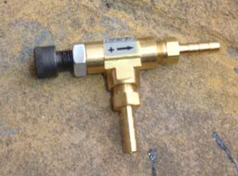

Step 7 - Purchase a ball-bearing style MBC (may be called a grainger valve), expect to pay no more than £25. eBay will be your best bet

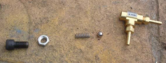

Step 8 - Here's what's inside, pretty self explanitory but :
1. The black bolt is used to compress the spring, the more you turn tighten it, the more pressure it applies
2. The solver nut is a locking nut to stop the black bolt from moving once set in position
3. The spring provides pressure against the ball bearing so it doesn't let air flow through the valve
4. The ball bearing blocks the feed from the bottom of the vale to its outlet
5. The valve itself - air is fed from the turbo into the bottom of the valve. Once enough pressure (boost) is applied, the ball bearing overcomes the force of the spring and pushes it out the way and air leaves the exit point on the right hand side to the actuator.

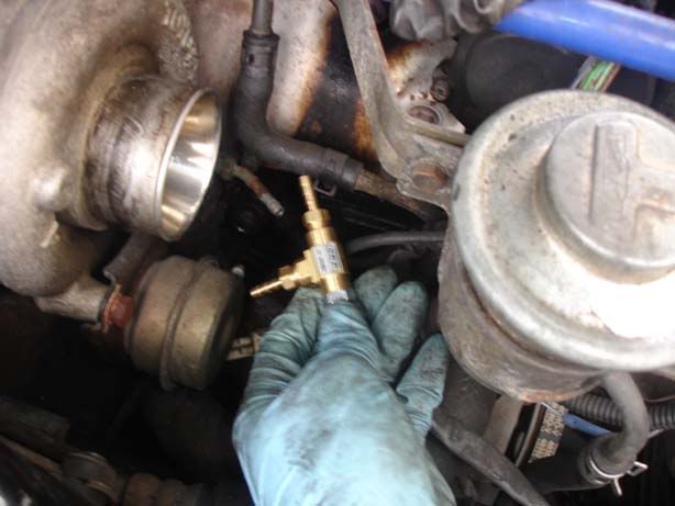

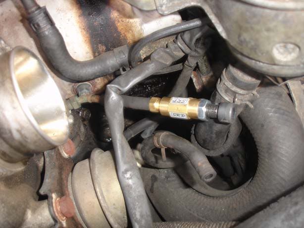

Step 9 - Based on the above explanation you should see the valve sits like this
Step 10 - The valve should be fitted with the smallest hose runs possible. You often see really long runs of hose but this means pressure will take longer to build in the pipework and can lead to serious boost spikes before the wastegate sees any pressure at all. Short pipe runs means it is harder to adjust your MBC but you should only need to do this on initial set up anyway
That's it really, all you need to do now is set the boost to the minimum value (screw the adjustment bolt all the way out so there is minimal foce on the spring) and then keep testing the car then tightening the nut until you reach the desired pressure.
