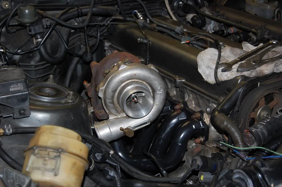

Well, I've been working on my buddy Aarons car for a couple weekends and finally took my camera over and grabbed a few pics.
We're doing a single swap on it, along with a new harness, ecu (Aristo harness, MKIV Gforce ecu), clutch, and fmic install.
the setup right now:
Aristo harness
MKIV G-Force ECU (8k rev limiter, no boost/speed cut)
Map-ecu
GT35r .68
Drewgo manifold
Tial 44 wastegate
Tial 50mm bov
2jz Cams
550cc injectors (will upgrade to 720s or 880s when we do a 2nd fuel pump)
Aeromotive FPR
RPS 3200 PP w/ full faced disc
Here are the pics of it so far. Need to fab the Cold IC pipe and button up the remaining parts and should be ready to go..
And a pic of my 2 cars (havn't had a chance since my buddy has been borrowing my supra since his has been down.).
The reasoning on the G-force ecu is that he didn't want to go stand alone but wanted to run all out without problems. MKIVs have run 700+ hp on the G-force ecus without issues so we decided to go this route. I think the 2jz ecu is the way to go if you dont want a standalone but still want to make good power (over 500whp).

Well got the ic pipes done, and nearly buttoned up. Waiting on a few more peices that should be here in a week or so then its done.
We decided that the 35r wasn't enough for what we wanted so we upgraded the turbo as well!
