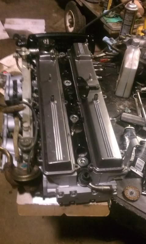

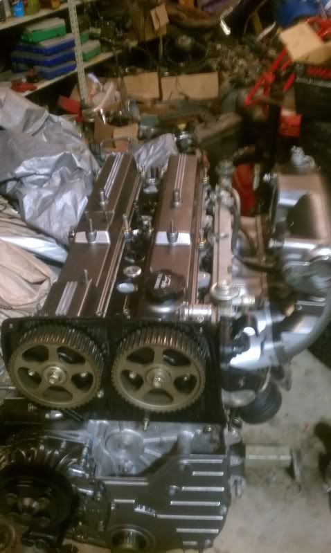

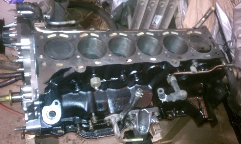

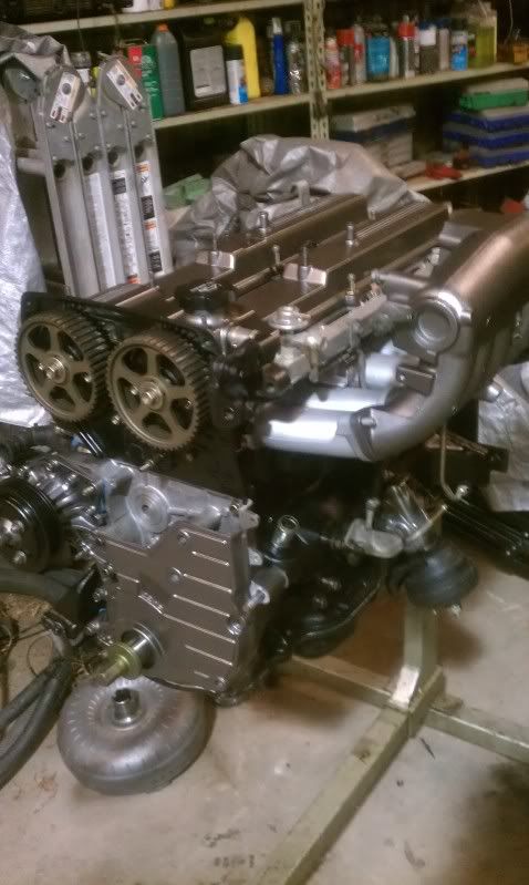

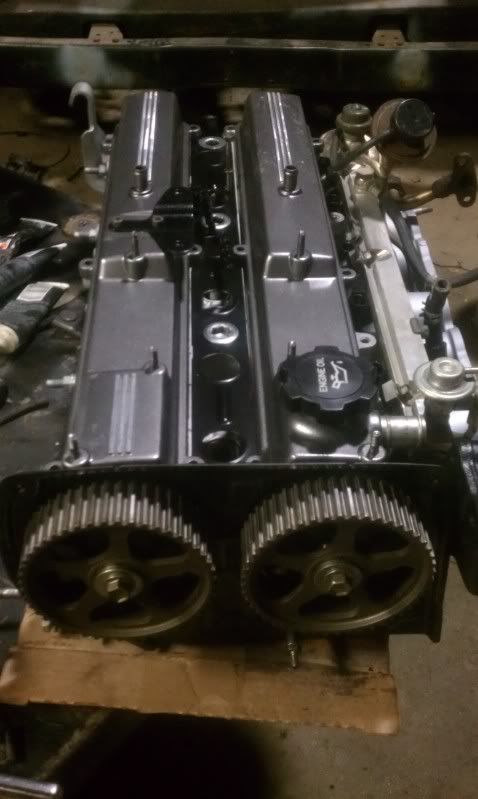

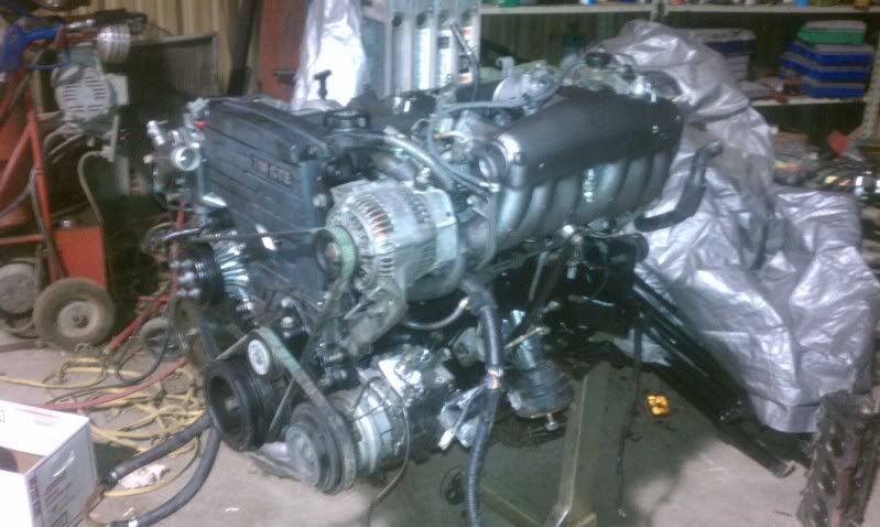

head back from machine shop and getting assembled.

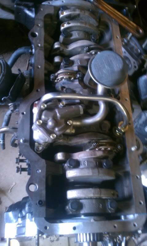

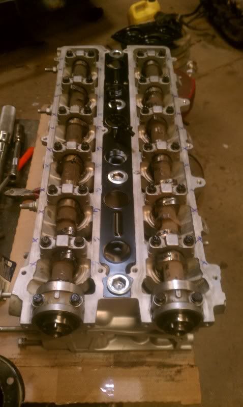

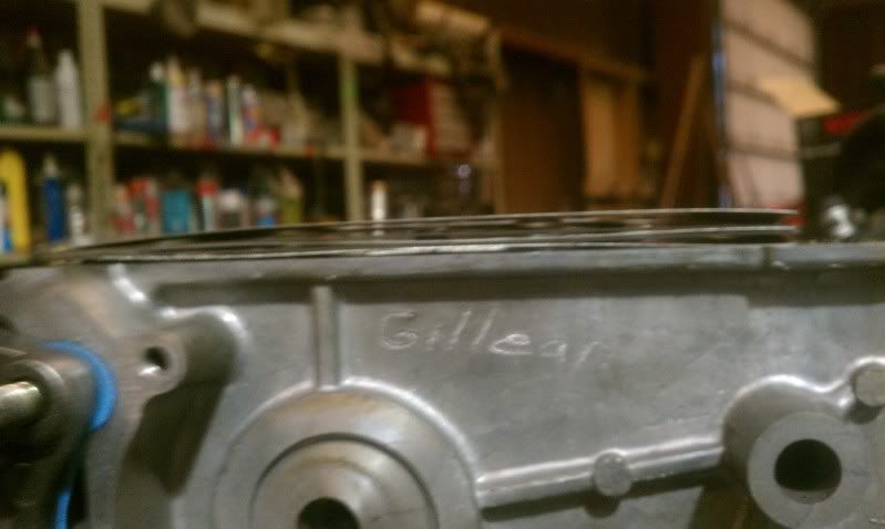

I always ask, but did the shop also deck the timing cover?
Welcome back. And don't call it a turd, call it a TRD.
defiantly a TURD. It will be a TRD when Im done. haha
Yea made that mistake with the last car, and did not have the timing cover decked. I learned my lesson on that one.

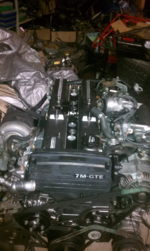

Well it looks good in pictures. The motor is no longer a turd. I will soon get the car to that status after a rebuild of the suspension brakes and drivetrain. cause it pretty much needs it all. I dont even want to drive it the brakes and suspension are scary.

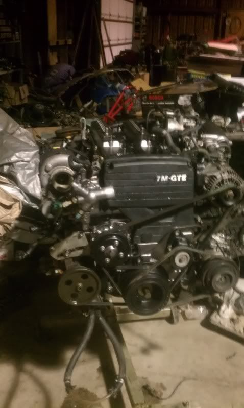

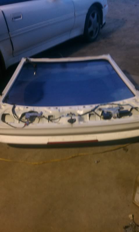

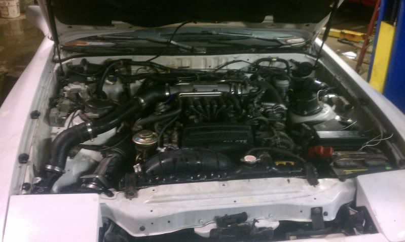

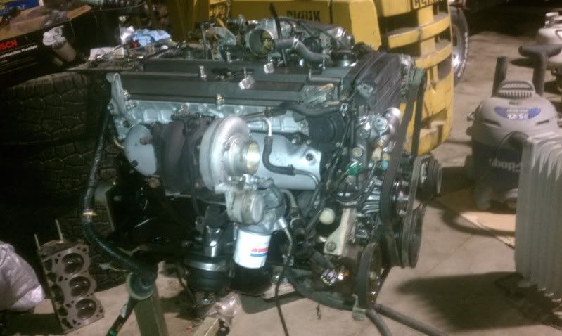

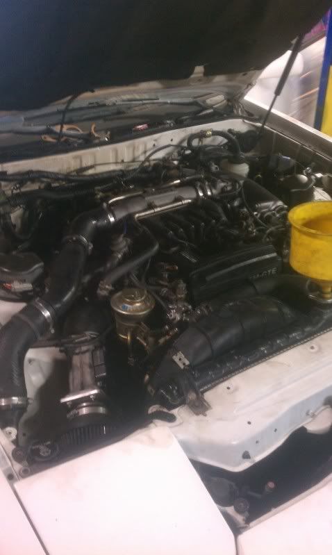

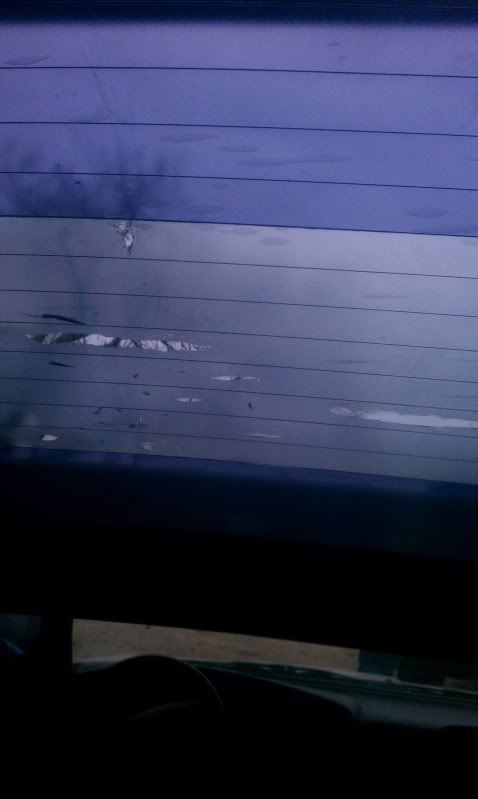

OK so engine is in and running great. I am amazed at how smooth it runs, I think it idles smoother than my lexus. Power is decent still at stock boost levels. Put about 150 miles on it so far and the starter killed over. So I changed out the starter and did my first oil change. Also trying to get this nasty tint off, I am just not having a good time with it. So I pulled the hatch and am trying some other things before I damage the defroster lines.

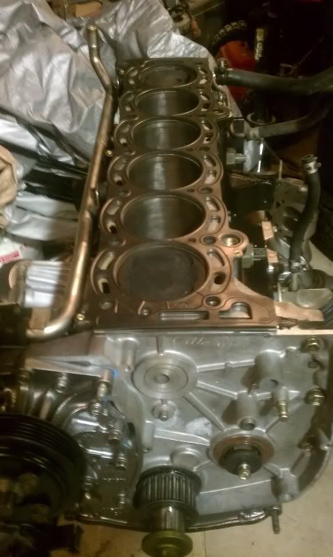

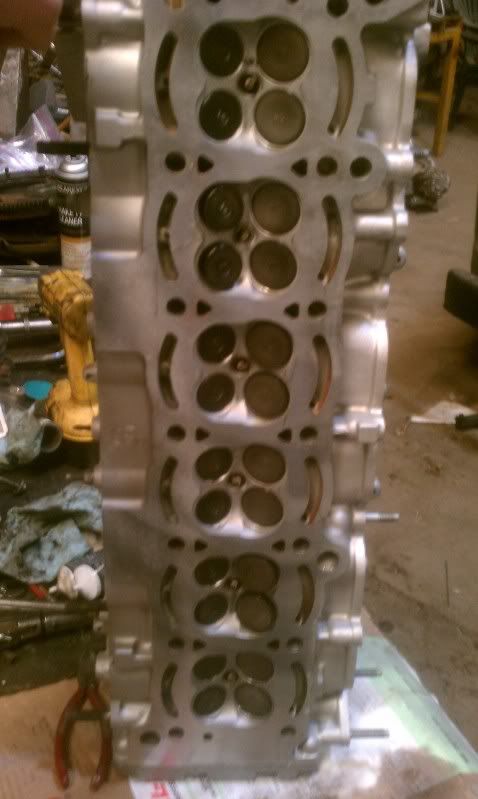

Got to love a smoooth 7M. How much did the machine shop end up taking off the block?
Heat will be your friend for this. Get yourself a heat gun/blow dryer or better yet a steamer. If you get it nice and hot the glue will come off with it, so you don't have to go over it with a razor and ruin the defrost lines.
They took .016" off the block and .008 off the head. They were pretty bad.
Ive got a heat gun and a steamer, nothing is touching it. Its delaminated so the first layer is still stuck on the glass. I used our heated power washer with 0 degree turbo nozzle and it didnt even touch it. Im thinking about trying aircraft paint stripper now

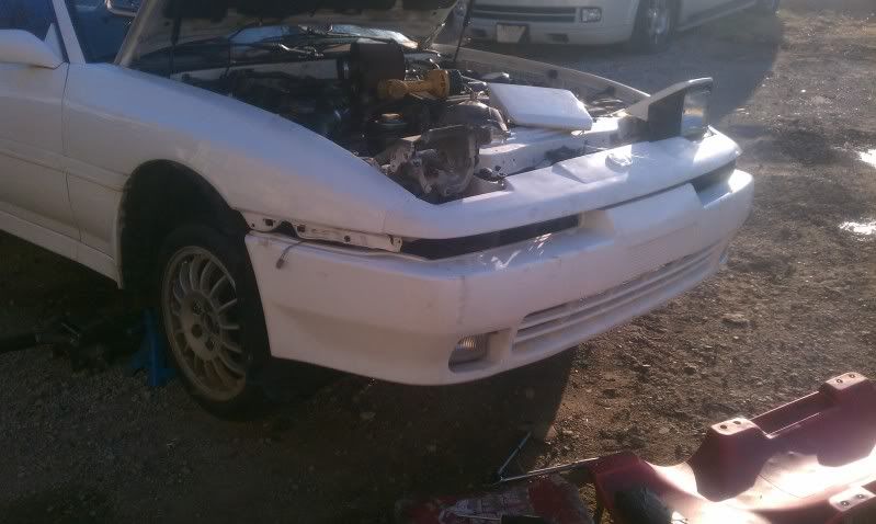

Got to do some pulling on the front bumper support, PO hit something and wrinkled the passengers side of the bumper pretty bad. I dont know if the bumper will straighten out but I got the bumper support pulled back into place and the fog light supports all bent back. Removed what was left of the OEM front lip and need to find another one, I hate it without it and the 4x4 look.

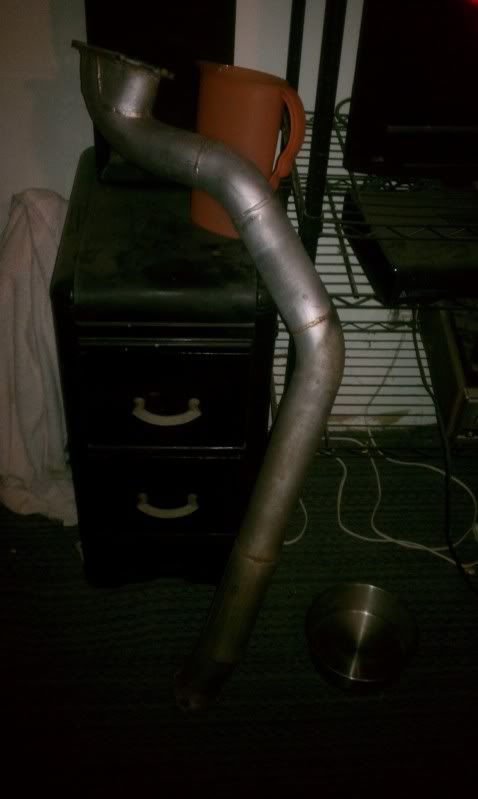

I got a BIC widemouth 3" dp installed. This pic is when I got it, I had it ceramic coated black before I installed it.

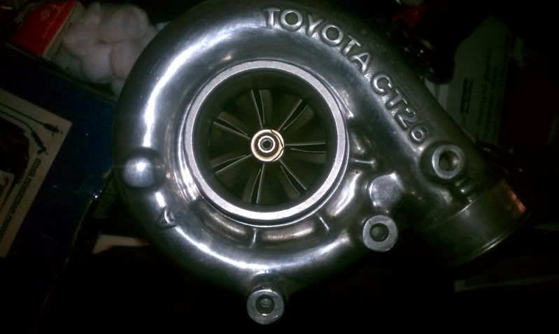

I also got a 57 trim turbo for it, needs rebuild and found a local diesel place that will do it.
it has a polished compressor housing.

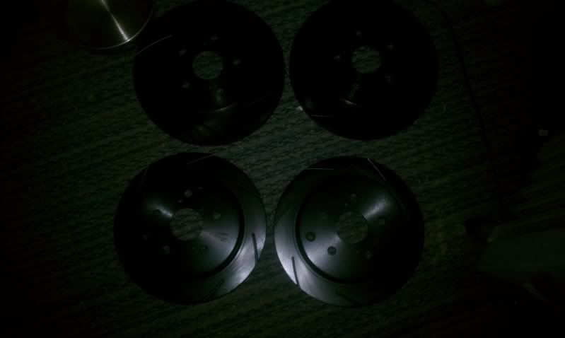

New black zinc slotted rotors for it front and rear from ABT on ebay. Hope they work out just fine didnt want to get cheap drilled rotor due to cracking. Also will be installing wagner thermoquiet ceramic pads all the way around.

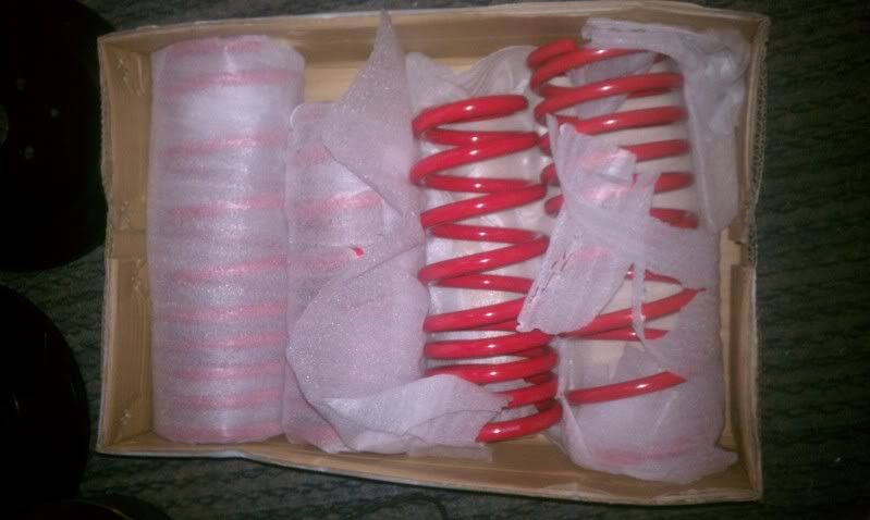

I also installed the lotek lowering springs on the front. drivers side was easy, passengers side I ended up having to pull the washer bottle and inner fender liner to get the control arm bolt out.

Got the PS hose changed. Also got the lotek springs and installed them
The front is a little lower than I would like. Trying to figure out some way to put a spacer between the spring and strut mount.

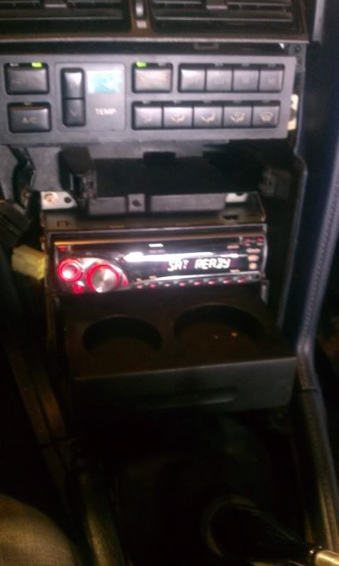

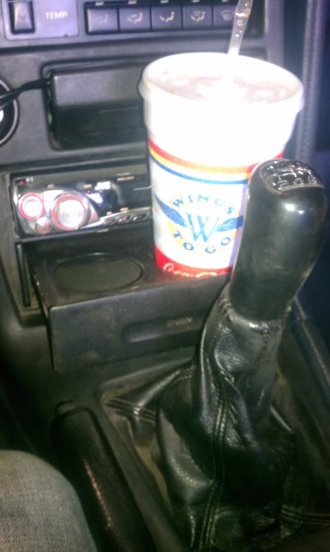

Also found this neat cup holder/storage tray. Its from a nissan maxima and is a single din size. I put it in with this shitty JVC for now. Works and the shifter is in 3rd. Plenty of room. Just cant change the radio station easily with it.
