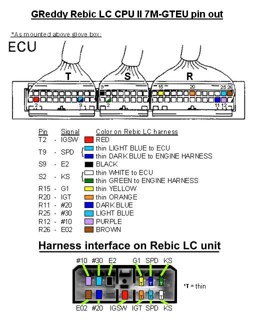

Will a Greddy Rebic LC for 88 Supra work on 89+ Supras?
guess the Cable´s gonna be different but what about the electronic side?
