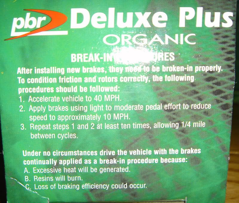

i didnt see this before. here's my break-in procedure on the box. it asks for light to moderate braking.
Ckanderson
Apr 1, 1983
2,644
The beach
theKnifeArtist;1129773 said:
true that, they're always alotta fun!
yup thats what stoptech recomends too
