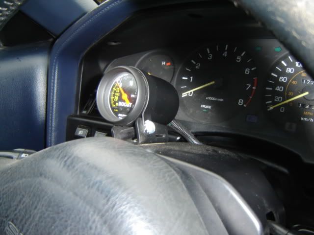

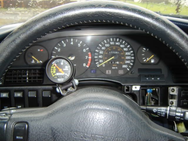

Here are a couple pics of my Auto Meter cup.

Fastway135 said:
Did you use a screw or a bolt/nut? Because i dont see where the screw would hold on to.
I used 2 screws, they go down through the bottom mount and straight through the plastic steering column cover. You can see them in the bottom pic.
