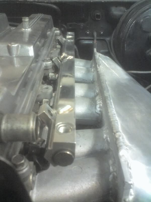

custom built by me FFIM

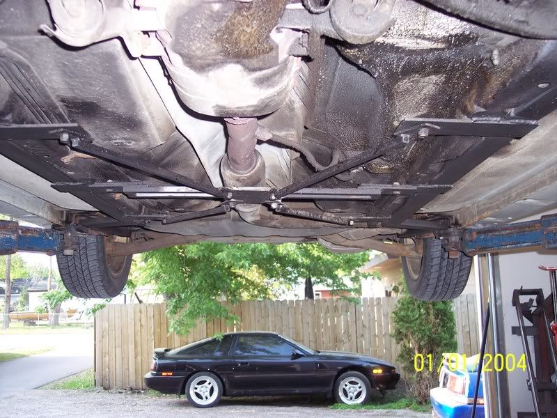

Custom built chassis braces.

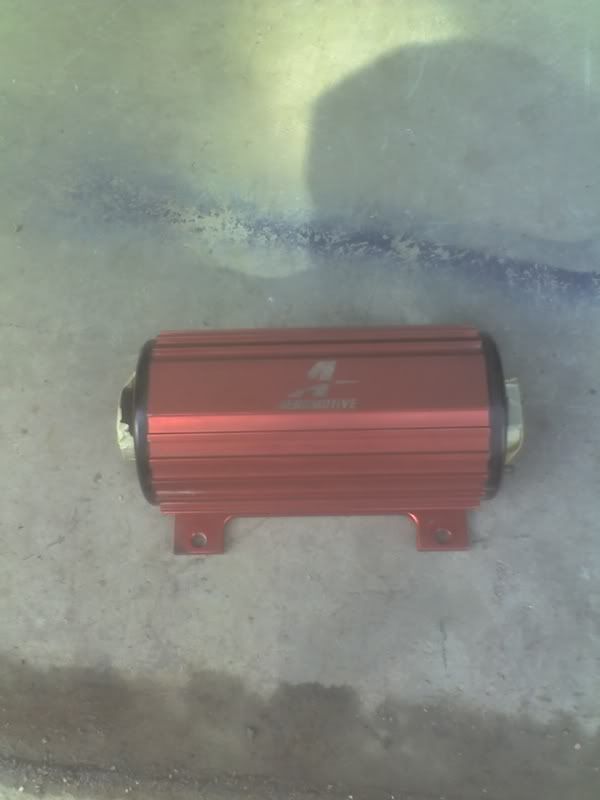

Aeromotive A1000 fuel pump

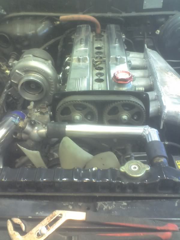

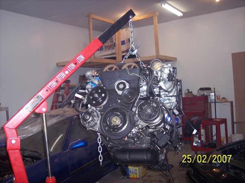

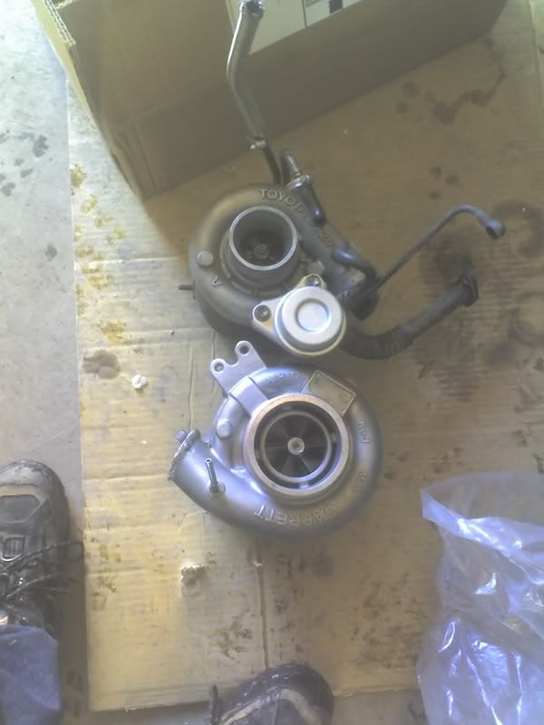

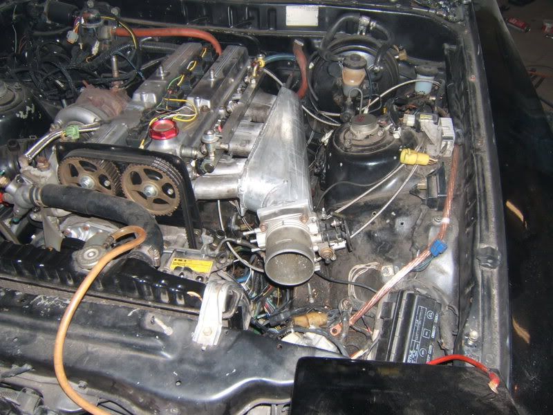

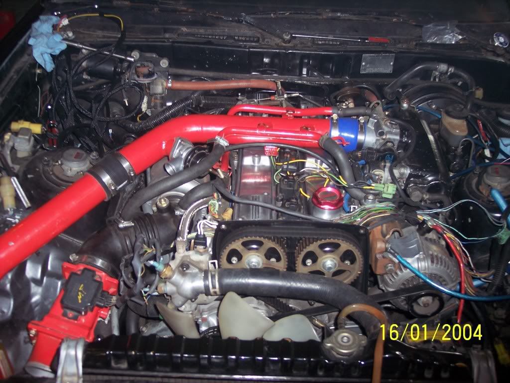

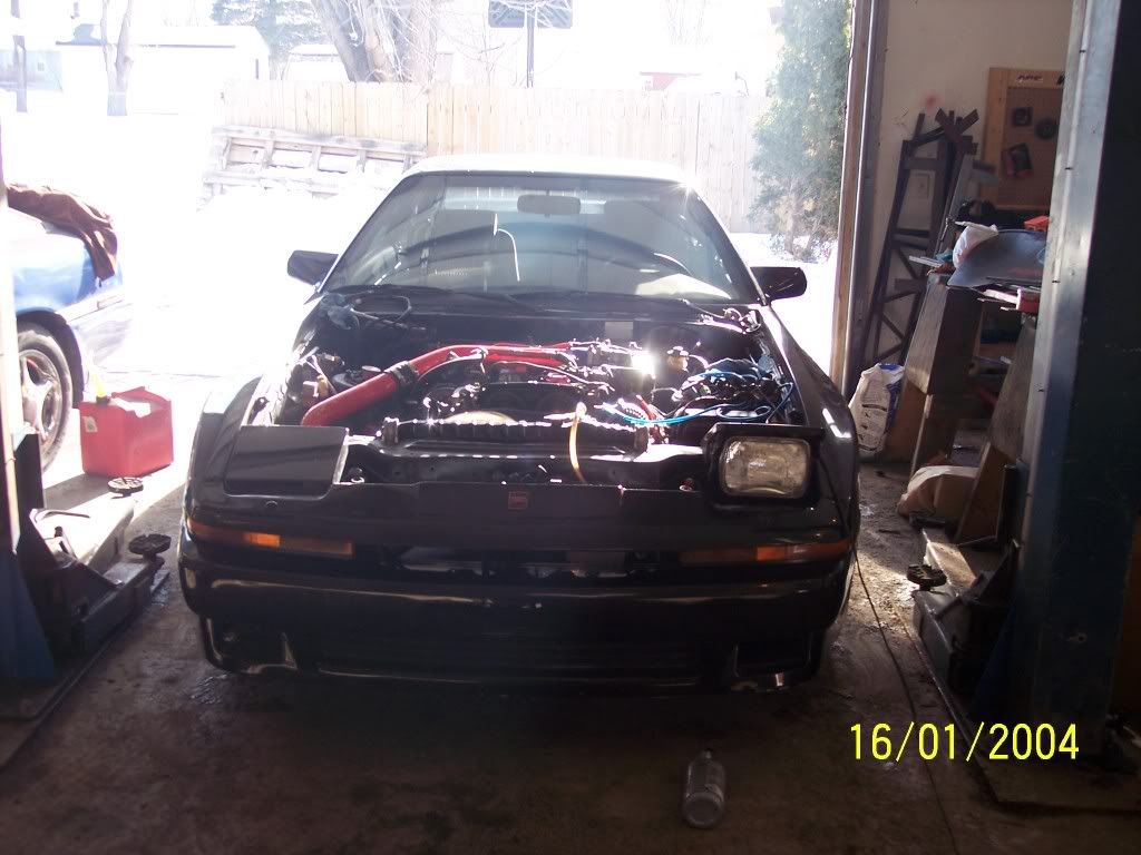

Well my buildup pretty much started with the removal of a 2jzgte.
The car then sat outside for awhile.
I got really sad seeing it out there all engine less for the longest time, so I traded my daily driver for a rebuilt engine with intentions of running at mostly stock levels for this summer.
My old daily.

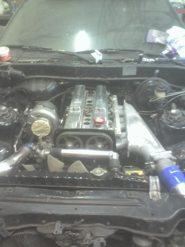

I then put some parts that where otherwise just lying around on my new 7mgte.
Then for some wild reason I was not satisfied with the way things were panning out. So out with the old.
And in with the new.
Some details on the build.
RC 720cc injectors
1/2" aluminum fuel feed lines 3/8" return
Garret gt4088 turbo
3" aluminum charge piping
24"x12"x4" cored intercooler
Fully ported head
knock off exhaust manifold
dual greddy type S BOV's (one genuine one knock off)
1jzgte coils
Lots more to come soon.

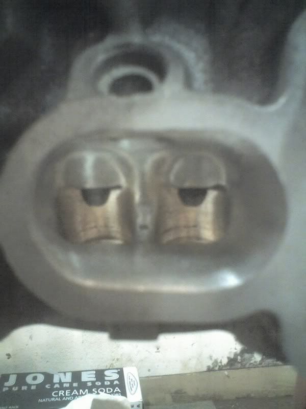

Something had passed through the engine roughing up the piston tops and a couple of them where hitting the cylinder head. Its now been rebuilt and put in the blue supra of my uncles. If it wasn't for him wanting the motor I probably could not have swung this project at all.

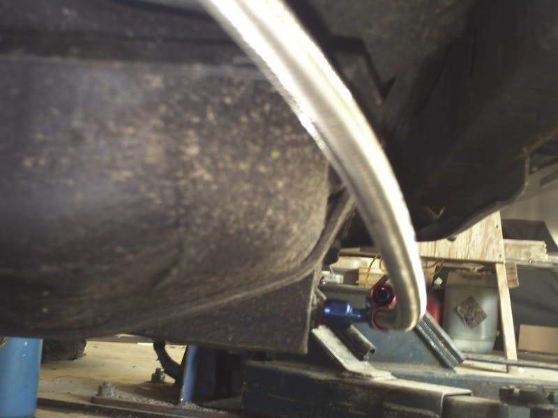

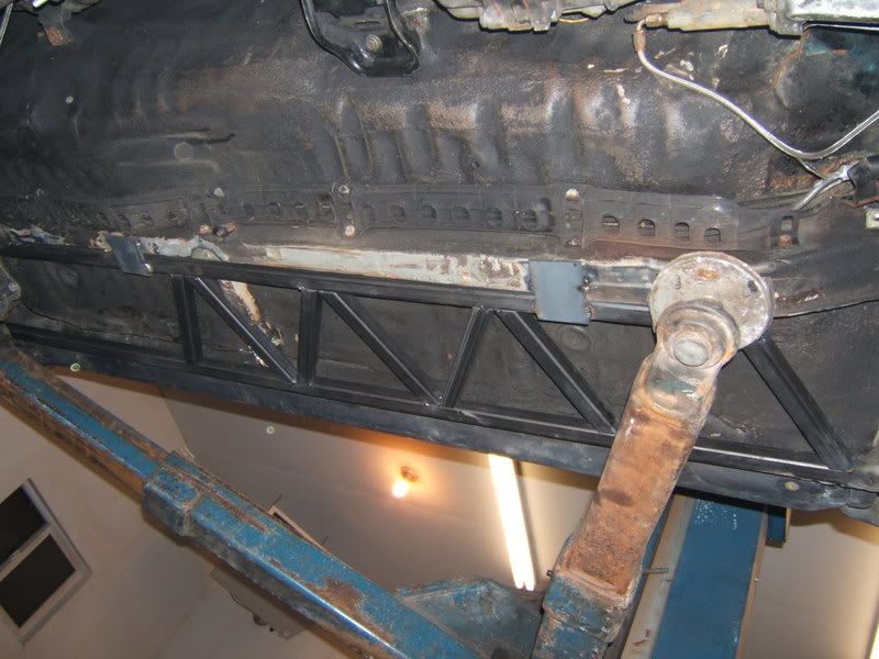

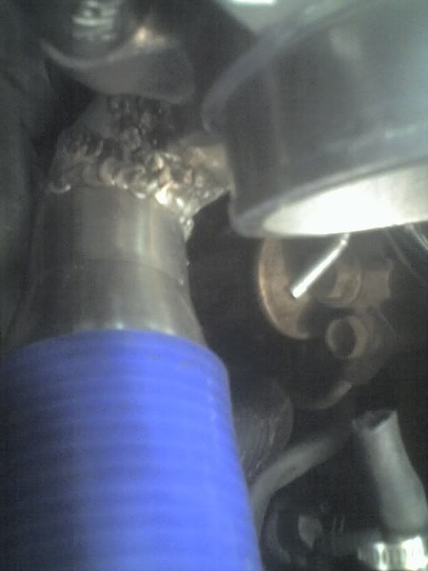

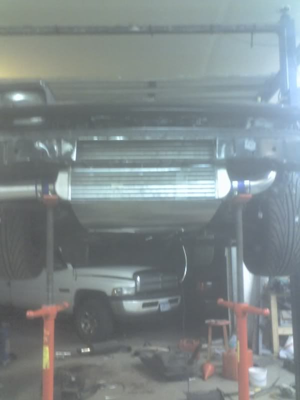

Heres some pics from today.

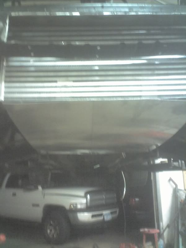

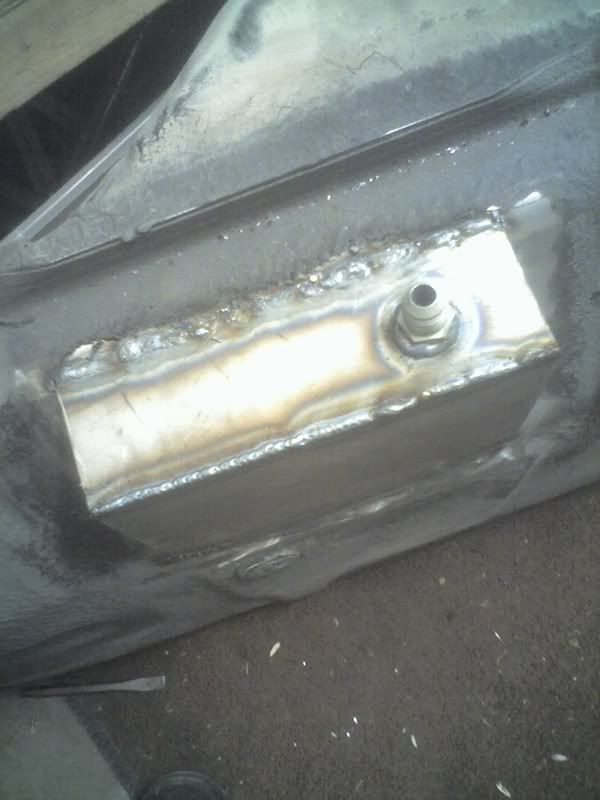

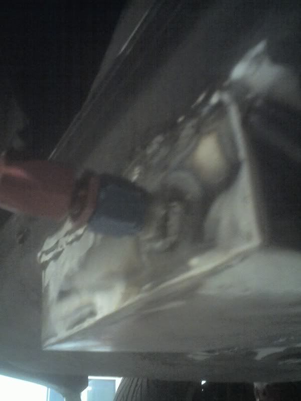

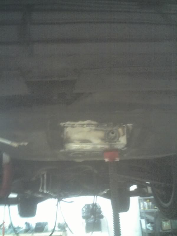

Dropped the tank going to be sumping it and most likely adding some baffles.

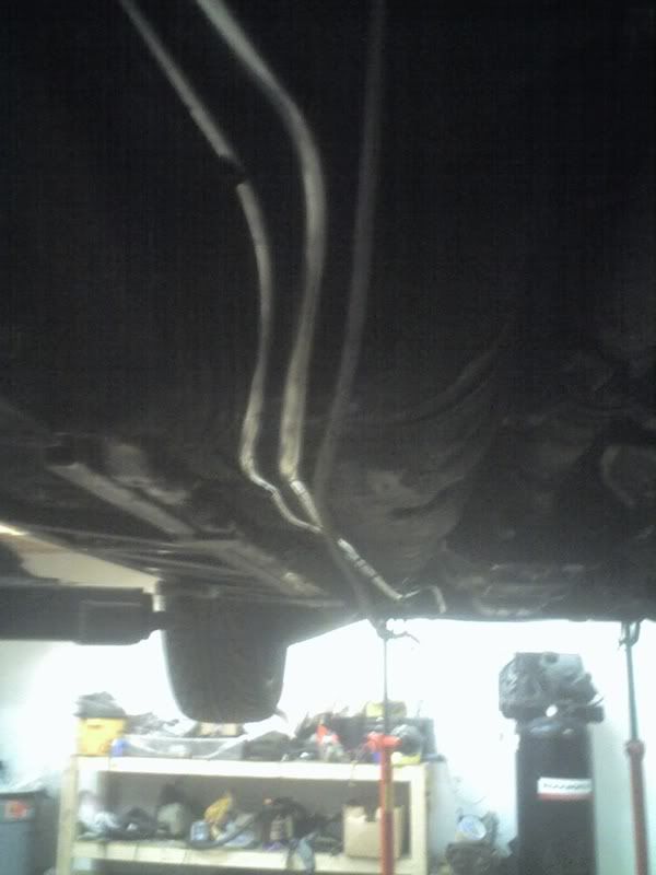

Ran my fuel lines.

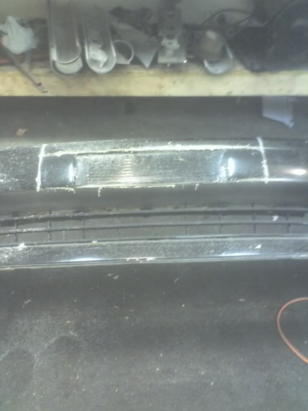

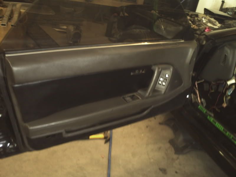

Started to mock up my aeropaneling.

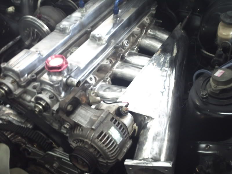

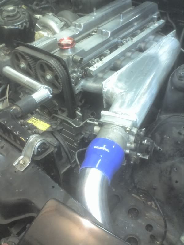

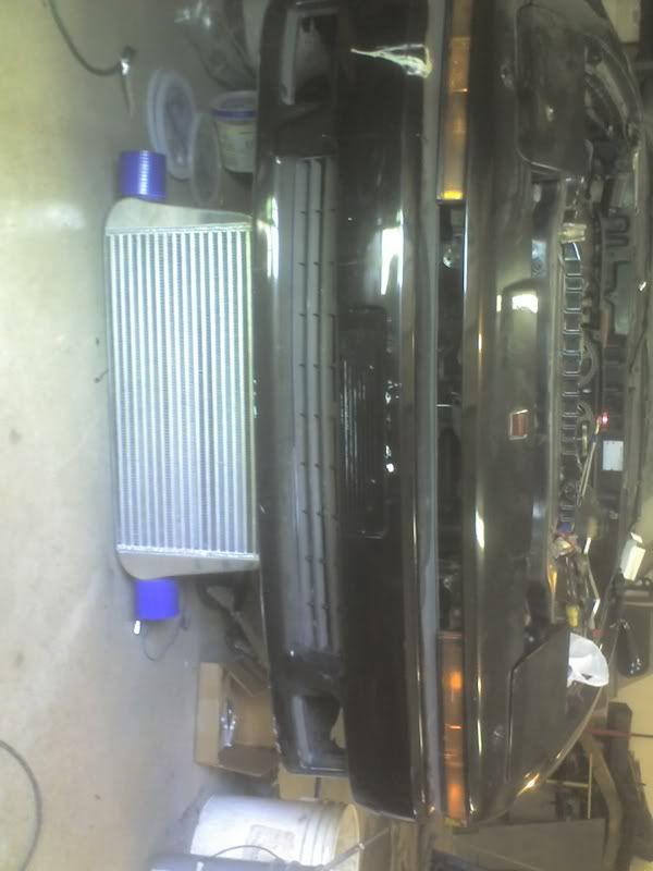

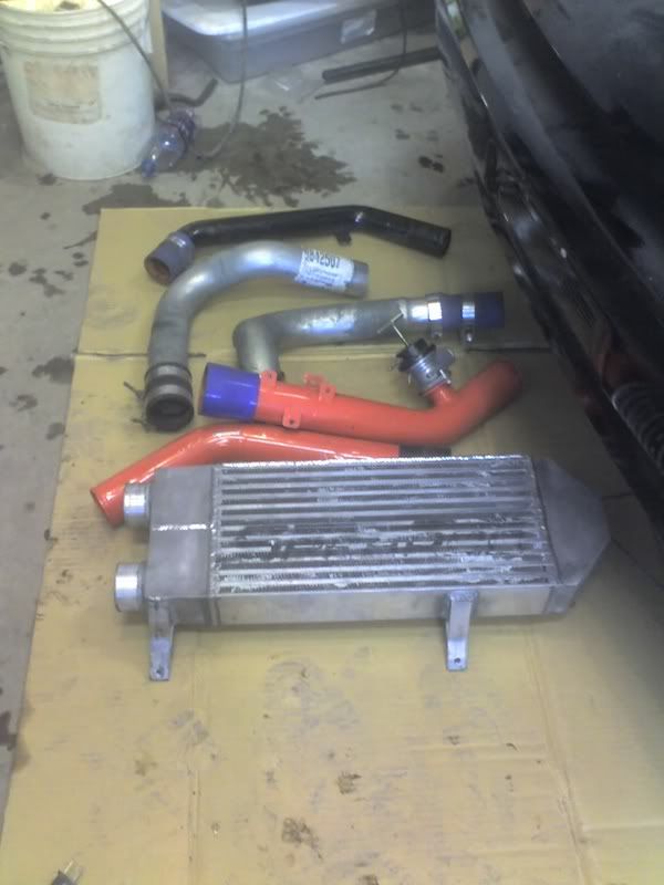

As well as got most of my charge piping done.
Pics.
I will be updating this throughout the week I want it running soon.

I don't have any pics right now But I took the head off to upgrade the head gasket and put my fully ported head on. As well I am now waiting on two keys components to come in the mail. An AEM EMS and an Aeromotive A1000 pump.
