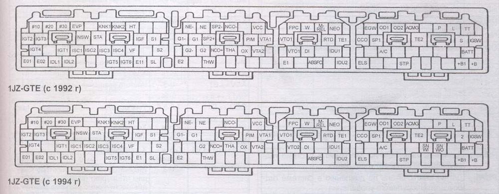

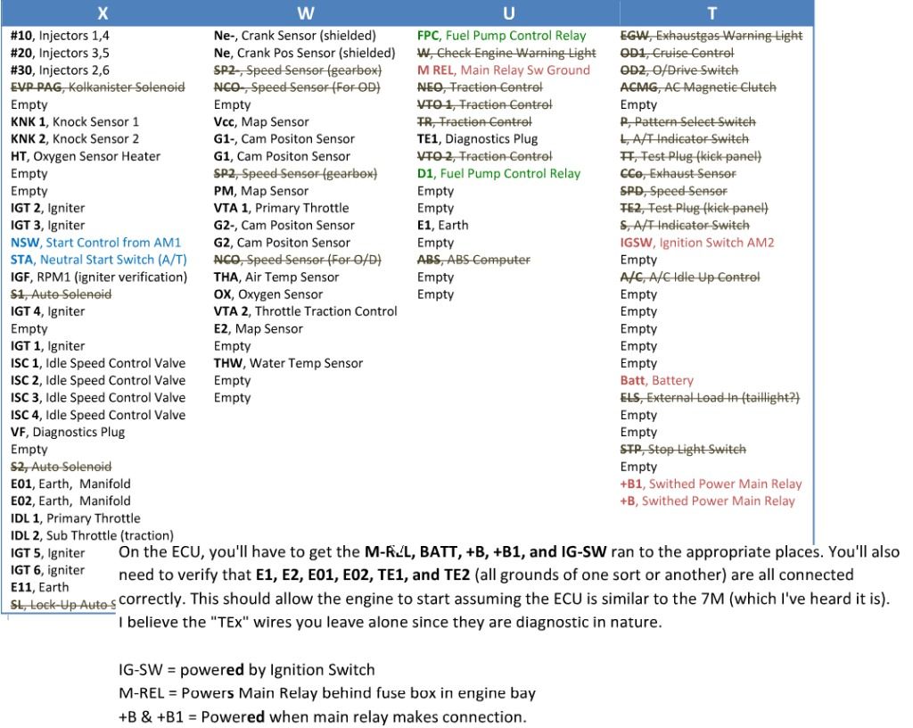

Im currently wiring a 1JZ into a 1987 mitsubishi starion. My question is which wire from the ECU can i use to power my fuel pump relay? I know on the pin out there are two wires that run to the factory fuel pump relay, but i dont have that. pin D1 and FPC. From what ive read already, you can not use FPC directly because at idle it doesnt supply enough volts to kick the relay on. So anyone doing an odd swap, what wire do you use from the ECU to send signal to kick on the Fuel Pump relay?
This is what im looking at. this matches my ecu

From wha I had read it only put out about 8volts at idle and kicked it up
To 12 above 1600 rpm. I wasn't sure if anyone else ha used this wire to kick on a normal relay. I wasn't sure if 8volts would be enough to kick the relay on. I'll try the fpc wire and see how it goes. Thanks for the reply.

There is a huge difference between JDM 1JZ Soarer/JZX FPC signal vs the US MK3 1JZ.
JDM models sends 5v digital pulses through the FPC-wire to signal the FPC-unit in the trunk. That again "steps up" the voltage on the stock fuelpump as the FPC signal changes form ECU. This signal-wire is a very low-current, signal-wire only... and not compatible with running aftermarket relays at all.
the US-spec 1JZ has a completely different Fuel Pump control system with just simple relays and a resistor to slow down the pump when needed. A far different sytem than the Soarer-stuff uses.

I was under the impression that there is a enormous "market" with 1JZ's in the US, for the reason that many supras came with 1JZ from stock....But further research confirms that only the JZA70 MK3 Supra had 1JZ from stock, and thats the JDM-version..... all the MA70's in the US came with 7M's obviously. Withdrawing my statement of "US-spec" 1J's ;)
But yes, your issue with the Soarer ECU and fuel-pump is a well known issue during swaps.
You can use the M-REL output, but it won't stop the fuelpump if you crash etc.
the M-REL turns on when ignition-switch input is activated, and turns off when deactivated (a small 5 sec delay i think)
If you want to utilize the stock FPC signal, you need a circuit like this to get it working with a relay, but then it's a fully functional Fuel Pump circuit:
