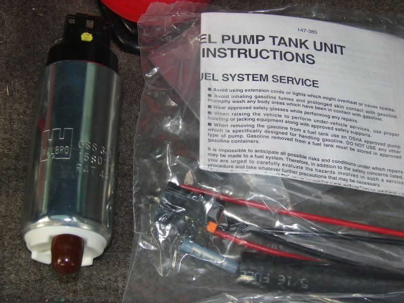

when i was going to replace my stock pump with a walbro i bought a used walbro and it said walbro right on the pump. I would guess that all of the walbro pumps say the name on them.

There are fake walbro's made that imitate the originals with great detail as well.

For a walbro. you need to splice the wire. If thereis no splice, than it is stock. Also, stock pump uses Blue and black wires, walbro I believe has black and red. Yours does look like the Stocker because a Wlabro is not that snug on the hanger.
