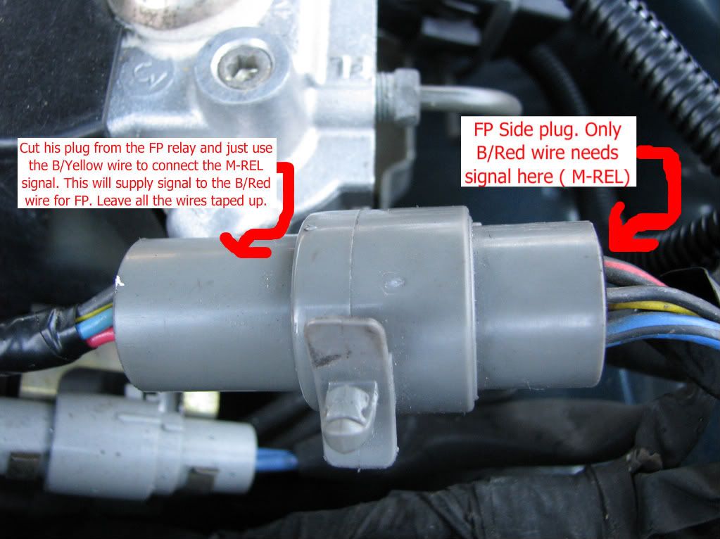

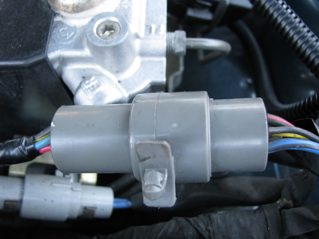

Anyway can someone tell me on the fuel pump resistor/relay connector (yellow or gray circle that has four pins in it, two up and down, and two horizontal pins), which one has power? Because neither one of them do when I put the test light up to it, and I really don't feel like dropping the tank again to do the 12v rewire.
And even if I dropped the tank, I'll have to use a different source cause apparently my fuel pump signal wire is no good.
ARRGH
EDIT: After a bit of searching FP on the diag block has no power. It's supposed to have power for a split second, then shut off. FP is not showing power at all.
Ok I need the pinout for the entire connector. I have yellow (goes to ECU) blue/black, and two other wires. When I jump the blue/black the pump kicks over. Yellow doesn't seem to have anything.
