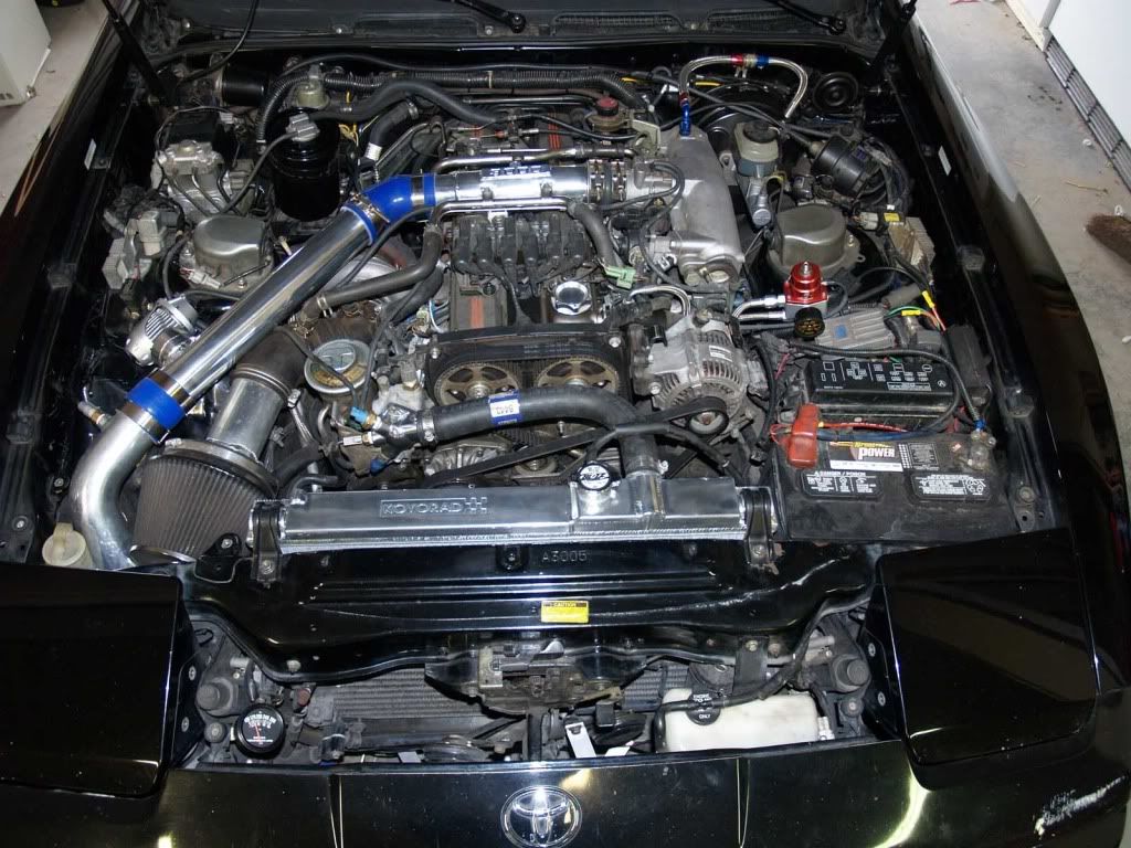

Here's a pic of my setup. It doesn't show the lower lines; but, you can see where the regulator is mounted and where the steel braided line runs. It's right behind the alternator.
Hopefully, someone else will post a pic of the lower setup.

The weak link in those regulators is the diaphram inside and it doesn't come with Stainless Lines or the proper fitting for the fuel rail. Hopefully, your diaphram will hold up. Definitely, upgrade that when you upgrade to a bigger pump.
Did my pic help at all? I'm sure if you search, someone will have pics of the lower section.
Since you're not running an upgraded fuel pump, there's no need to drill out or bypass the J-Tube. Put another way...DON'T drill it out or bypass it. ;)
Remove the stock FPR. Go from the fuel rail > your regulator > J-Tube. If you have all the proper fittings and such that is.
