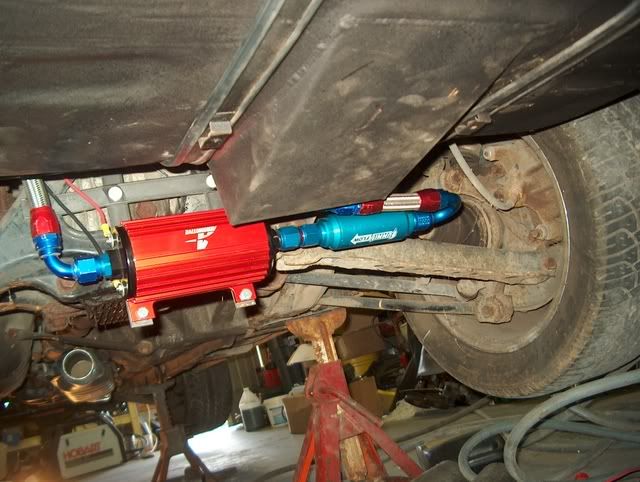

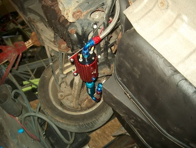

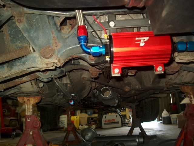

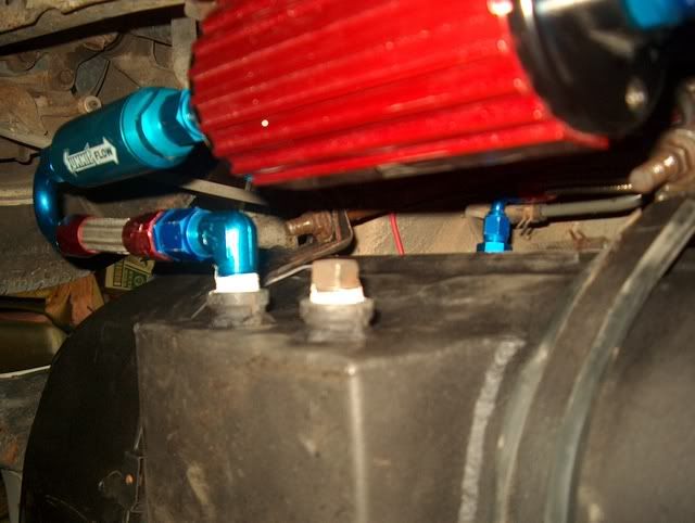

I run the A1000 with -10 an feed and -8an return with a stock fuel rail, oem sumped tank. I sumped the front of the tank so the cops dont see it and painted the pump black. But i do do keep my tank at least half full of gas so i dont have no Fuel issues.
uhh don't run the car like that with a sump in the front :nono:

Front sump? Dang, I would highly suggest NOT to do that. Not only when you drag race but if you decide to hammer it, you will have to worry if you will ean it out.

Oh he can, not an issue unless drag racing where the fuel WANTS to go to the back. During day to day driving, not too bad an issue.
yes a very bad issue, unless he does his driving in reverse.

You all have your opinions without knowing the facts..... If you read my very first post i said that i keep my tank at least half full, i full my tank every time i drive my car and its my weekend ride. I dont take long trips either. And when i had my sump welded in i had baffles installed to keep the fuel in the front half of the tank.
