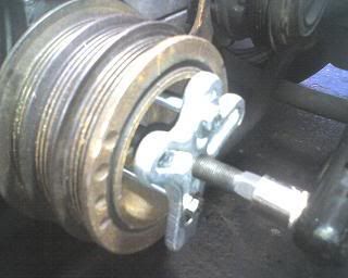

you dont want a pulley puller, you want a two-bolt puller like a steering wheel puller or the like. Then use two bolts that bolt into the pulley holes next to the center hole, and pull it out. If you use a three jaw puller it will probably damage the pulley

something like that
The one I have can be two bolt or 3 bolt and works on steering wheels as well.

I just bought one from an auto parts store, it's a harmonic balancer/steering wheel Puller. The only problem is the bolts that came with it dont fit, I guess I have to goto the hardware store :/

Ok, I got the Pulley Puller and managed to get it off with ease

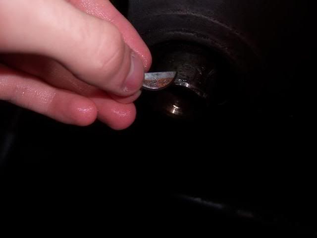

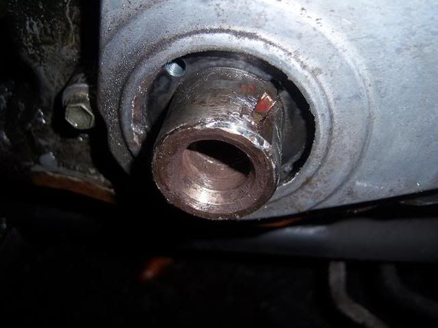

But now im bugging out because I think I damaged something. I piece came off of the thing behind the pulley. Is this how it is suppose to be? or did I break it?
