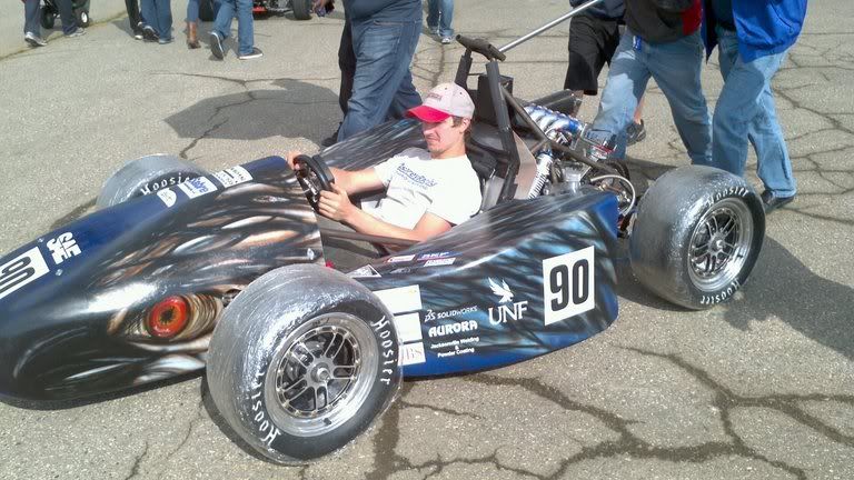

the car was pretty popular, for anyone who may have visited the competition you likely saw it:
