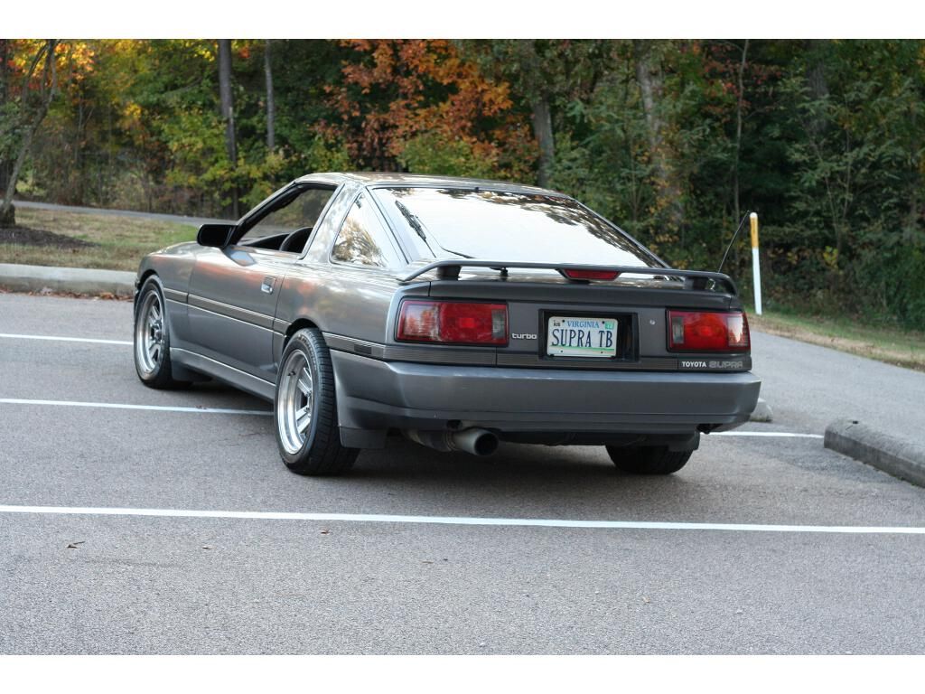

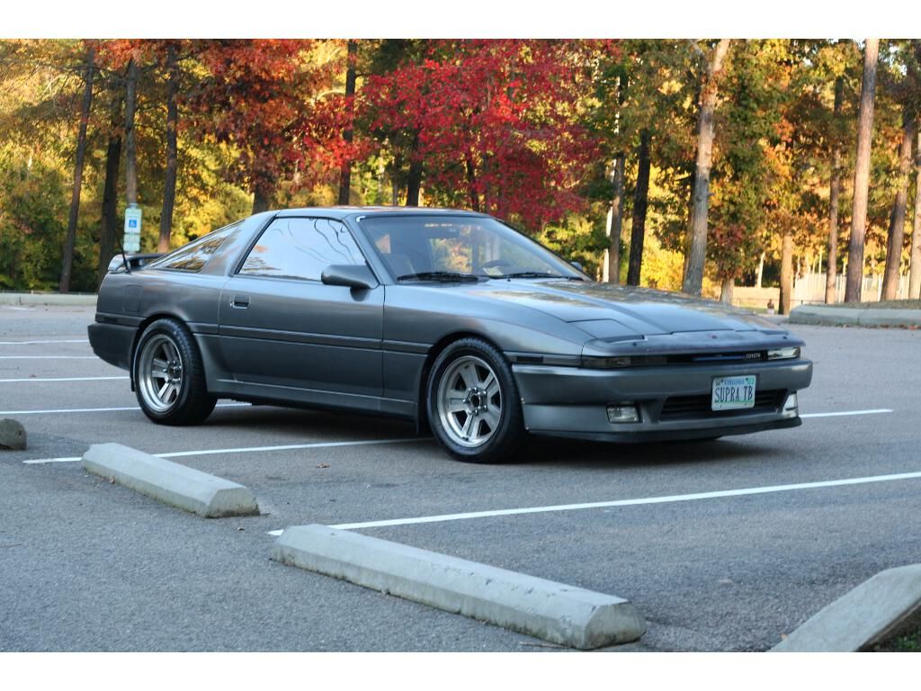

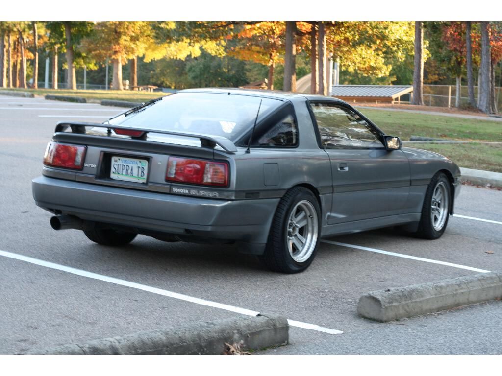

Question: I posted this in the Wheel/Tire thread but since several of you are running the same config I figured I'd ask here as well.
I'm running 225/50r16 Sumitomo's on 16x7 (front) and 16x8 (rear) and am getting rubbing in the rear on road bumps, on a dig, and in corners. I'm using the Eibach Pro/Tokico Illumina II's setup for ride height, and would like to know what people are doing to stop the rub. Here are some pics of my stance.
Drake69
Enjoyin' mah ride...
Aug 24, 2009
648
56
Richmond, Virginia, United States
That's true, but the combination of 16x8 wheels PLUS the skinnier fenders found on 86~88 Supras (89+ are much wider...) adds to the dilemma.
I have 215/45 r16 tires coming that will hopefully correct the problem. If not then I'll be in the market for 2 16x7 wheels to trade for my 8's.
