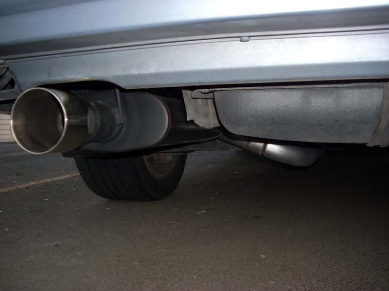

Recently I went to a local exhaust shop looking to fab up a custom exhaust for my 87 NA AT. I went with the managers recommendation (my first mistake!) and they ran 2.5” pipe from the cat flange back to a glasspack, then back to a Flowmaster 40 delta 3” in 2x2.5” out muffler #430402. They expanded the 2.5” pipe at the muffler to fit the 3” inlet. Outside the car it is pretty loud with a kickass tone, but on the inside it booms/drones hard from 1400-2800 rpms. Nice for a weekend/track car, but a bit much for a daily driver.
I am thinking of moving to a Flowmaster 50 delta 2.5 in/out with a single tip. The 50 series is supposed to be quieter but I was wondering if anybody has been down this road before and has any advice before I start throwing more parts and my wallet at it.
