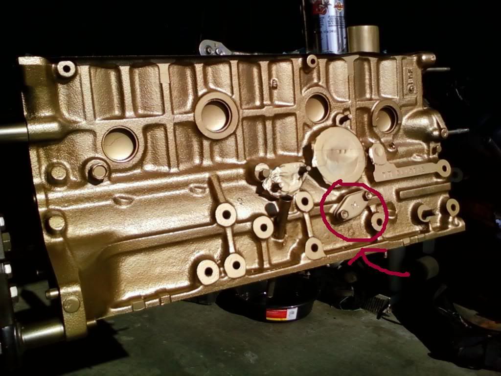

take you oil filter off and unbolt the plate with a M on it and put a new gasket there and some FIPG and sung it up this is what happened to me and took me forever to find it.
---------- Post added at 08:36 PM ---------- Previous post was at 08:35 PM ----------
Snap just saw you said the intake side my bad for not reading the hole thing.
