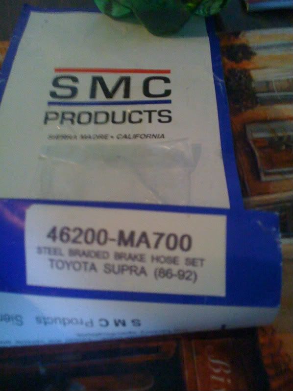

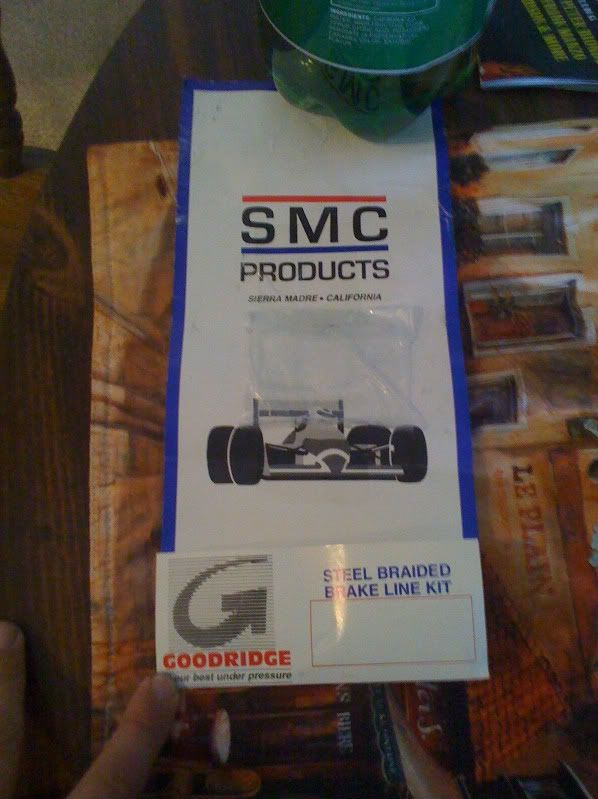

I've done a fair bit of searching and did not come up with anything, so if this has come up before my apologies. The issue I'm having is with a set of SMC Products brake lines, but the packaging also says Goodridge on it in several places so I'm not sure who really made them.

One other thing I'm noticing looking around at other kits made for our cars. You guys that have done this install before, were the lines on the front in 2 peices?
The lines I have in this kit, are all one peice for the front, which is further adding to the difficulty of install. And leading me to believe I got the wrong kit.

I purchased and installed a Goodridge kit for my '88. All 4 lines were 1-piece, and while I did have problems getting the retaining blocks and clips into position they all finally gave in and cooperated.

Do you have a pic of the packaging from the lines? It seems strange some goodridge lines fit well and some don't.
