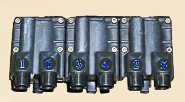

so i know its silly to ask, but for some reason when i look up firing order, there are 2 repspones.
153624
and
163245
which one is correct?

Both are correct. The top is the firing order. The bottom is the coil pack. The adjacent numbers are adjcent because they are companion cylinders in the cycle.

Although the adjecent coils on the pack are so because they are companion cylinders in the cycle. Just not what he wrote.
