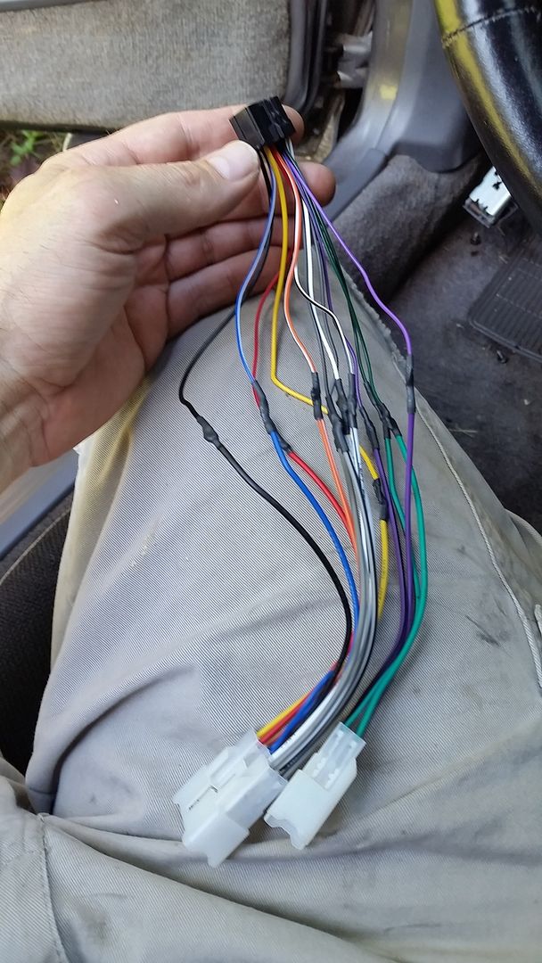

Metra harness adapter - $7.00
various terminal connectors and loom - $10
So, I put together a system for just over $270. I had also replaced the front speakers with cheap kenwoods, about 2 months ago, for $30.
So all together, we'll call this a $300 system. The Pioneer has Bluetooth, hands-free calling, Pandora, and can be connected to XM satellite for around $40.

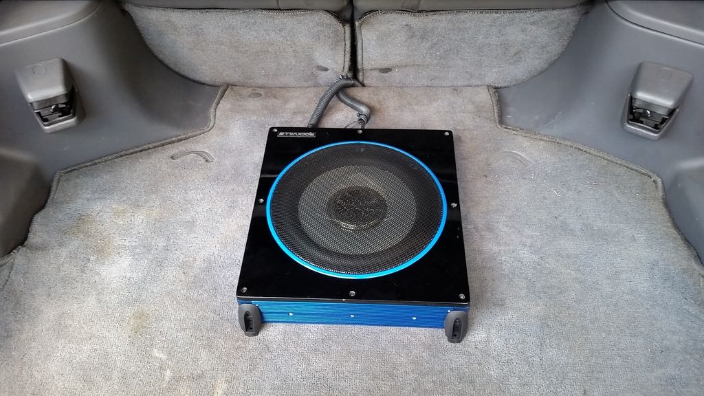

The sub is by Rockville. Yes, a stupid name for a low-end sub. BUT, on Amazon, it was VERY highly rated for output and durability. Along with the fact that it can fit
under the targa top in the hatch, and I was sold. the install took around 5 hours, because I decided to do everything as well as I could, so I'd never have to touch it again.
The harness adapter is a must-have, if you want simple, and you don't want to hack up the car's connectors.

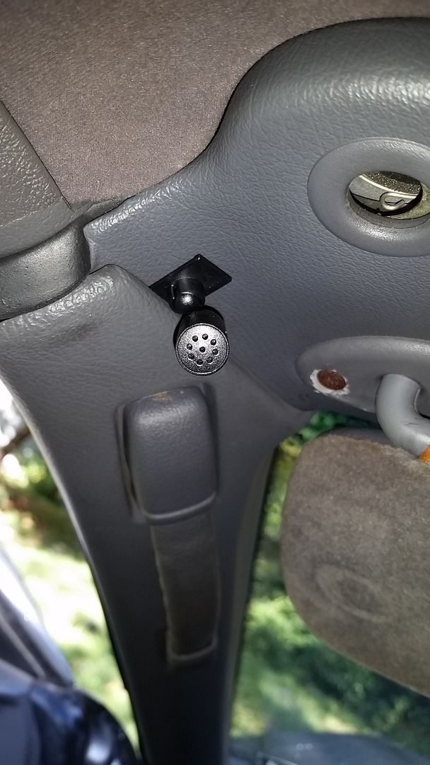

The hands-free mic didn't take too long to install. I removed the A-pillar cover, and fed the wire through the oem harness clips to keep it clean.
I then simply fed it down the side of the dash, and across to the stereo area, zip-tying as I went. The A-pillar was the best location for audio quality,
according to most people online.

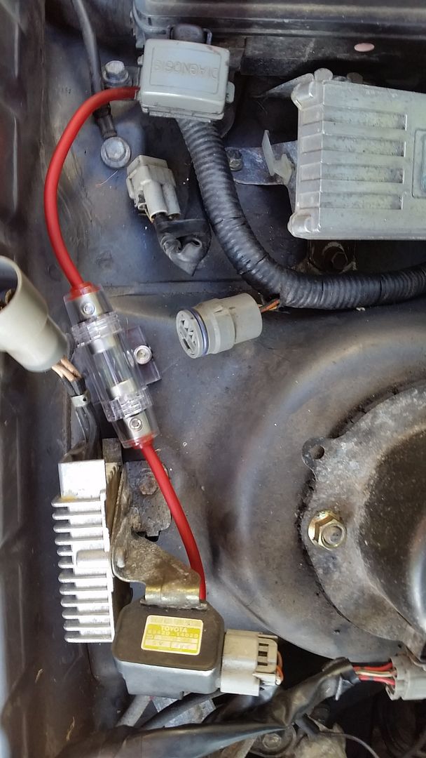

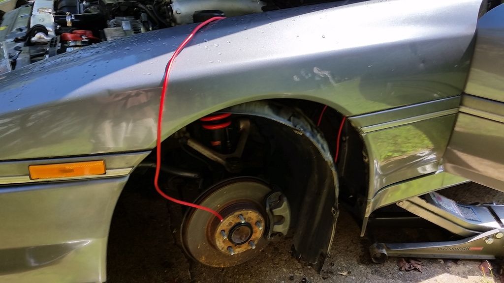

The power cable for the amp: I decided to run it along the oem path towards the drivers' kickpanel. The extra effort to unbolt half the splash shield gives you access to an
existing grommet just above the K.P.
Placed the fuse holder next to the diagnostic port, using an existing M6 threaded hole.
The amp/sub's rca's, remote lead, remote control cable were all fed under the center console, under the rear seat, and up to the amp.
The Power cord was run inside the oem harness sleeve, that runs under the rocker panel carpet.
The ground cable was actually bolted to the support bracket that allows the rear seatbacks to swing down. It was perfect, because it's right next to the amp, and right between the two seat backs.

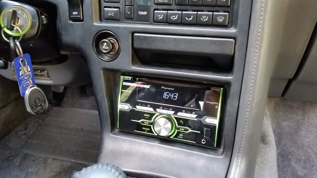

The Pioneer unit pretty much fills the oem space with nearly zero gap. It bolts right in, using the oem brackets. I'm VERY happy with the sound, and Bluetooth calls are very clear.

Thanks. Yeah, I like the oem color matching, but you can change both the button and backlight colors separately to any combination that you can imagine.
