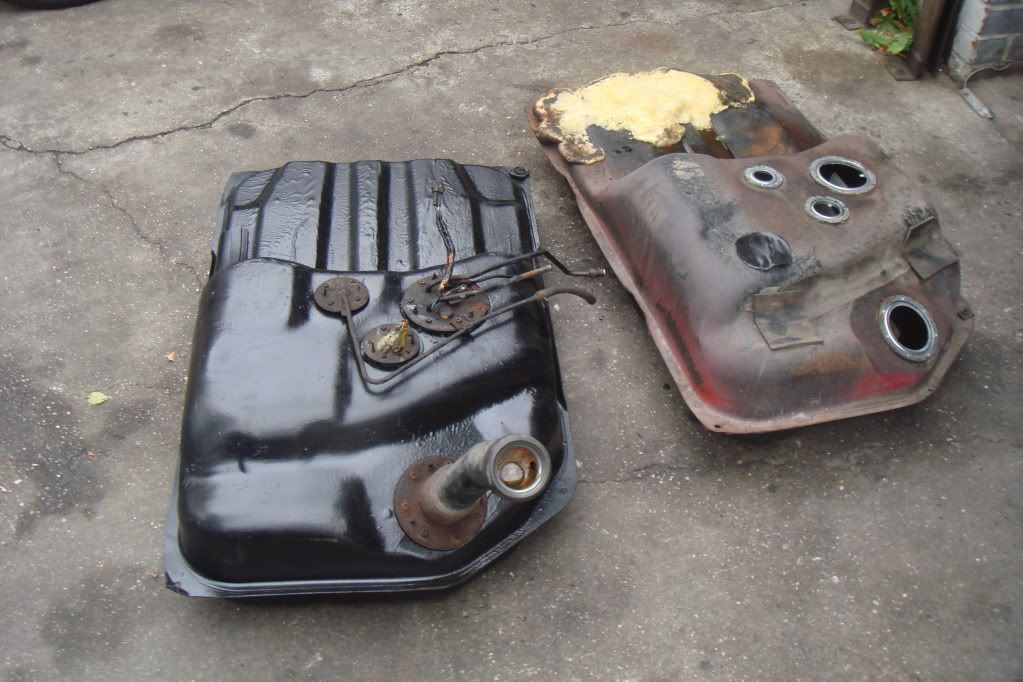

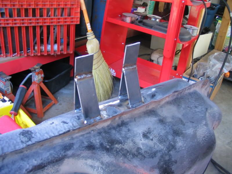

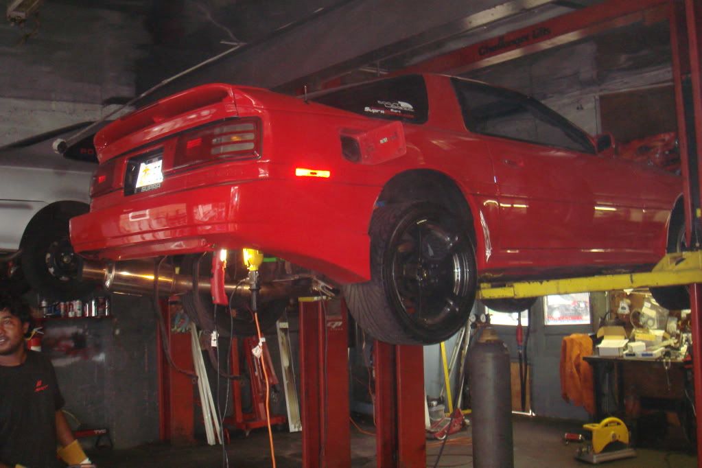

History: in 2003 I had an aermotive A1000 mounted above my Diff, over the years gravity and sediments in the fuel tank finally killed it. I also did not have a pre-filter, I only had a post 100-micron filter.

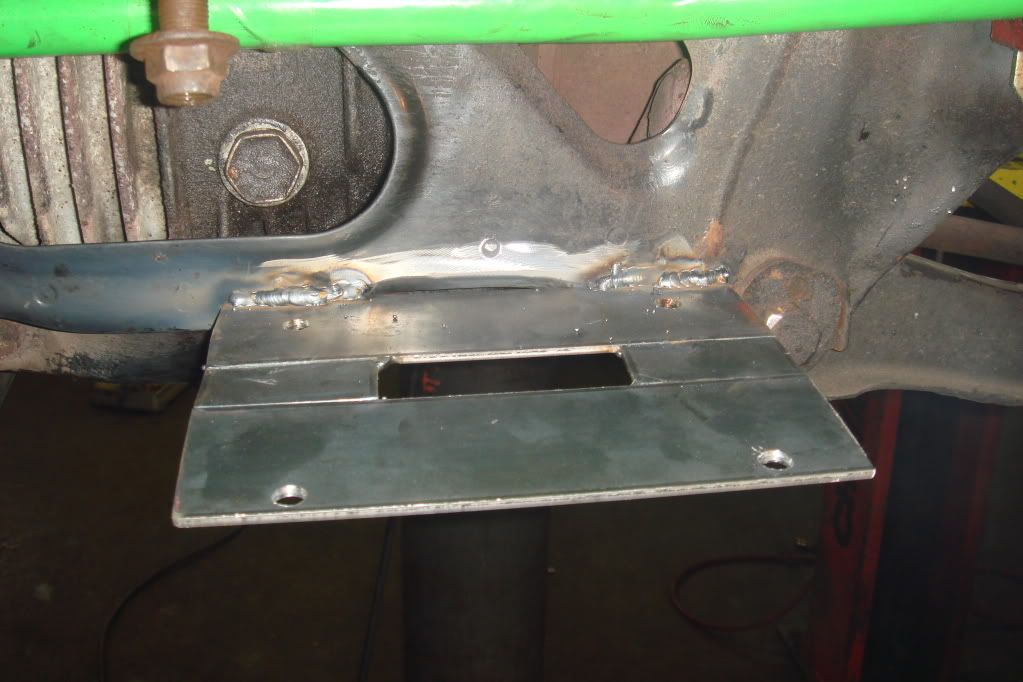

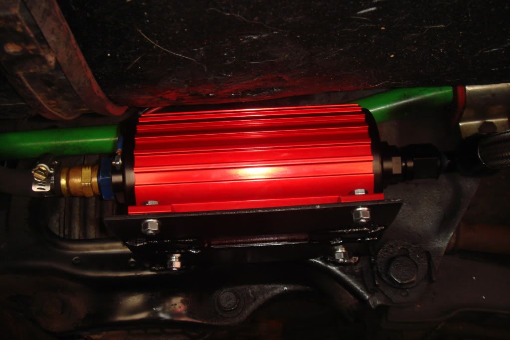

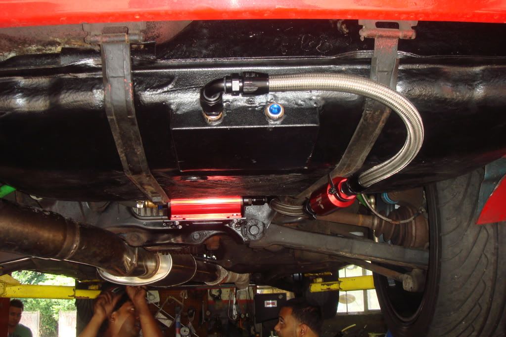

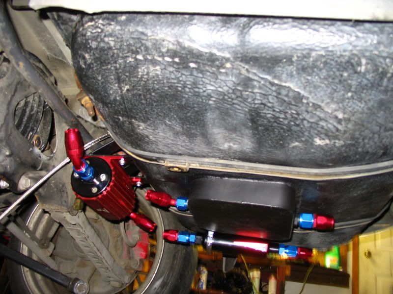

Now I have a pre 10 micron and a post micron filter, here are the pics. The 100-micron is not pictured, it's directly under the driver seat (underneath the car of course)
