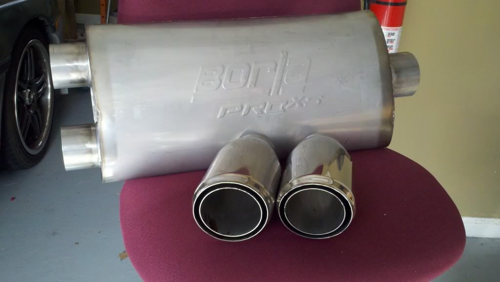

Post a sound clip if you get the opportunity. I plan to replace my fart can with a Borla once I get to my engine build stage.
Still working on the front suspension stage though, so it has to wait. But I did buy the muffler and the tips:
I think I'll copy your example though, and paint/ powdercoat the muffler black- looks good.
